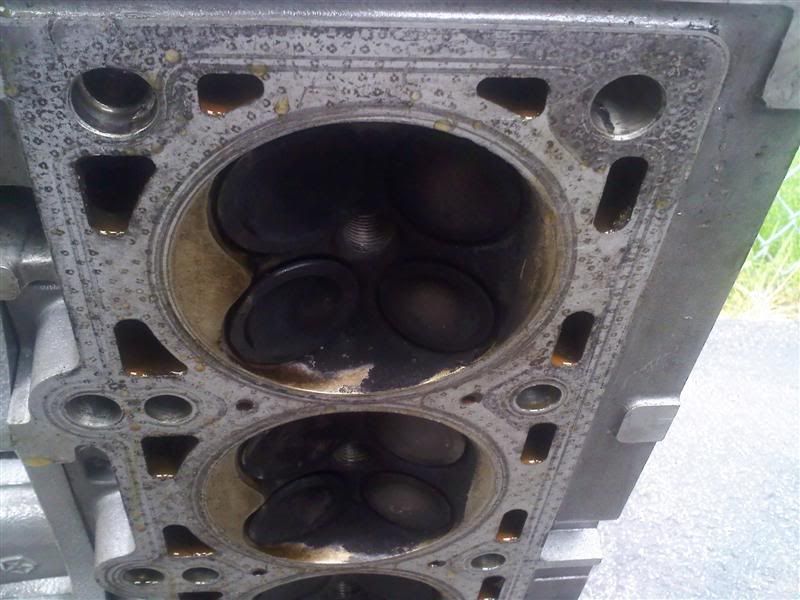

Did compression test (cold motor, no miles on it)...
160-150-190-190
WTF
So pissed again. Don't know what the hell is wrong now, as I made sure the pistons/rings were 100%, head is flat and everything was done right. Thinking of just calling it quits and towing to a shop. I don't have time to tear this down YET again. Either that or sell it. Option B is looking really good right about now.
160-150-190-190
WTF

05-03-2010, 11:47 AM
Head and valves are all good. Had the head checked out this last time it was off.
Well I can't think of anything else on what's going on with this car. It seems like it should still be running better than it is even with the compression numbers like that. I'm going to play around with it somemore and see if I get any results. If not (which I'm not holding my breath), I'm sucking it up and towing car back to the garage and doing tear down #3. I'm pretty sure at the garage, and with a helper... I can get it torn down and back together in 2 days.
The ONLY other thing I can think of is that something with the emissions is stopping the car from running. I don't have any of the sensors I pulled off anymore so can't reinstall them. But besides the wire tucking, that's the only other thing that changed from when this last time.

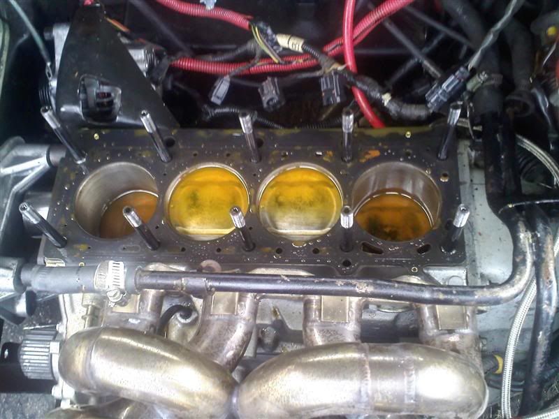

I think my update can be summed up with one picture...
http://i59.photobucket.com/albums/g291/david-b/Motor%20Build/0529002001Medium.jpg

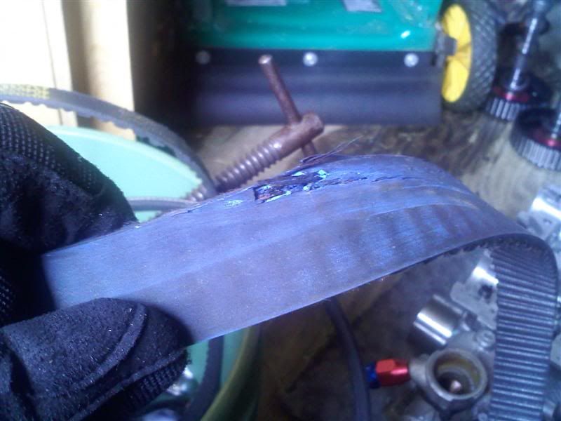

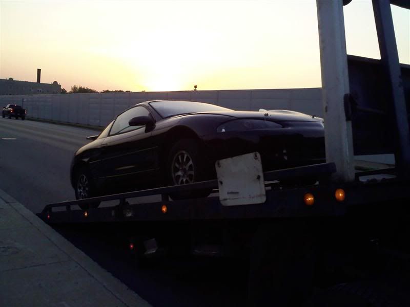

Yup... again. Got the car running yesterday morning with a new IAC. Worked out some kinks with MS and thing was running great. Did some pulls with the wastegate open. Reconnected that up, but stayed out of boost.
I was having problems the crank bolt backing out. Kept having to tighten that up and I thought I had gotten it good. Went to get the car washed, and the power steering went out so I knew it was loose.
Literally 2 blocks away from the wash, I hear this loud rattling from the bolt is, and I go to pull over, pop it out of gear and pull over, and it dies. I check out the bolt, and it's sticking out. I try cranking... won't turn over. Feels like no compression.
After waiting for 3 f-en hours for a tow truck (only towed 2.1 miles to my house), it was already dark so I didn't have time to pop the hood. Today I'll see what's going on on this thing. Not happy.

http://i59.photobucket.com/albums/g291/david-b/Motor%20Build/0529001850Medium.jpg
Died at the end of the runway

Turns out the alternator belt came off the pulley and got sucked through the timing belt. Pulled off valve cover and checked timing. Off by about 3 teeth. Going to pull head and check for valve damage. Replace any damaged valves, and then redo timing. It's a day long project, assuming that the valves are in good shape. So not really too concerned about it. Already done this too many times lol.
With that bolt, I torque it with the timing belt wedged so it doesn't move and go until it can go no more. I didn't put new thread lock on it though this time around, so I will do it next time though.

Ya it does sucks. It's my fault though for not having the timing belt cover on. Amazingly I'm pretty chill about the whole situation right now which is weird for me. For sale sign is actually not in the window this time around.
But I will be buying then entire timing belt cover. I was going to make my own originally, but never got around to it. Sadly, was too late. I'll mod it so I can still get to the cam gears. Thinking some kind of custom plexi glass cover. Not sure yet. Just need a cover on it though. Will try to find one today and hoping to have the head off someday during the week. And then depending on damage, may be back together on Sunday.
Just looked at timing belt, and it's chewed up. Going to replace that too as well again since I'm in there.

Finally got around to pulling the head after lots of rain and no time. Amazingly, pulled in about 3 hours total, and that includes pulling off the timing belt, tensionors and everything else.
Long story short, some valves got bent after the alternator belt got caught in the timing belt, causing no compression. Still, I'm totally cool with it though. Pics!
You can see the 2 on the intake side here are not seated properly anymore. Looks like a total of 4 (2 intake/2 exhaust) got hit. It looked like more, but after looking more closely, I think that was all. The 2 pistons have a little mark on where they hit. But the car was idling when it happened so everything (minus the valves) survived thank god.
http://i59.photobucket.com/albums/g291/david-b/Motor%20Build/0612001427Medium.jpg
Probably should have drained the block before pulling the head

Looked at the timing belt, and kind of glad I decided to buy a new one... this one is beat up pretty bad. The metal in the belt was popping out here, and some other small tears and rips in other places. I really need a timing cover, but cant find one anywhere. I'm going to buy a bunch of sheet metal and make a custom one. I have some drawings on what I want, but I know it's all going to change once I actually start on it. Should be fun.
http://i59.photobucket.com/albums/g291/david-b/Motor%20Build/0612001435Medium.jpg
Now my question, I'm just going to replace all the valves. I had gotten a 3-angle valve job 3 or 4 years ago when I originally built the head. Do I have to take the valves and head to my machine shop to get them reseated?
On a side note, since the Grand Am was out of commission and my g/fs car had brake problems, I got to drive her dad's Ram 1500 Hemi :D Beastly. Compared to driving the Talon and GA, this thing sits so high and just so big. I think the inside of the cab is bigger than the inside of the Talon. Massive.

ned032002
06-13-2010, 12:32 PM
Luckily that's all that happened. I will post on a couple forums I'm on to see if anyone has the timing belt covers for the 420a

boostjunkie333
06-14-2010, 03:36 AM
How do you plan on cleaning all that fluid sitting on your pistons?

david-b
06-14-2010, 10:18 AM
Got my siphone and was going to start sucking it out (that's what she said), but it didn't work. So took those shop rag paper towels and just let them soak it up. Before the head goes back on, I'll oil up the top just to make sure they stay lubed up and don't score when starting.

Just ordered valves as well. Plan on pulling the old valves tonight and prep the head.
Ya actually just got a message from him. We'll see where this goes.
vanilla gorilla
06-14-2010, 11:38 PM
When I pull a head, I usually just suck the water out of the cylinders with a wet/dry shop vac, lol.

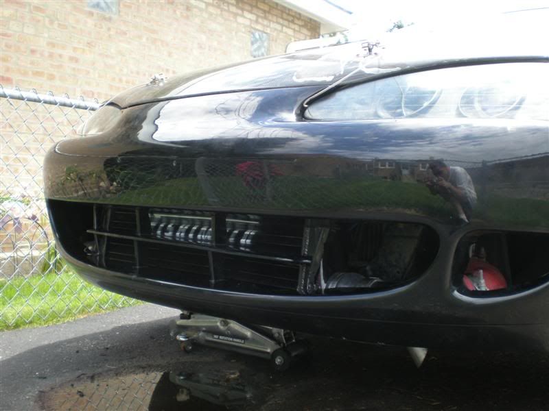

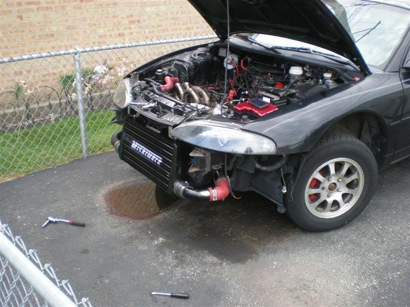

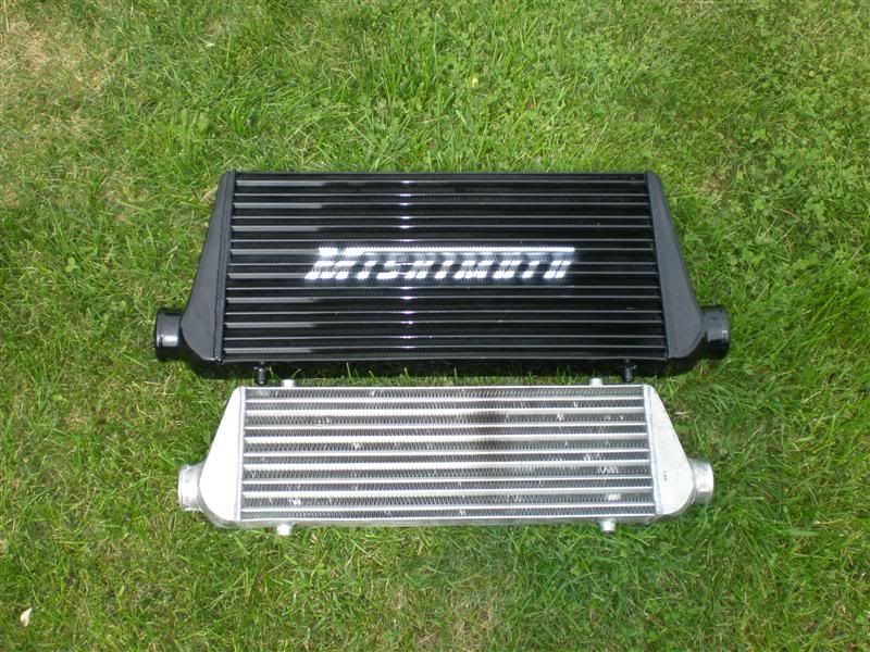

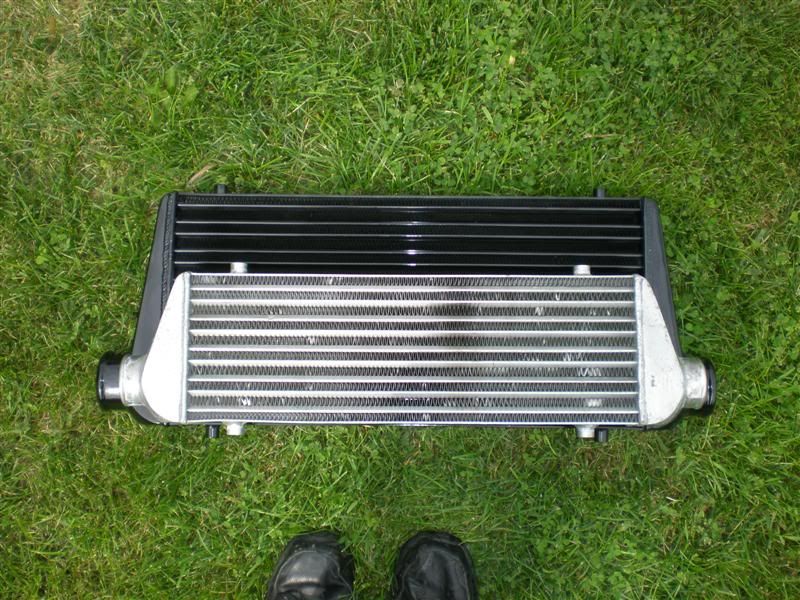

Valves were supposed to come in on Friday, but still not here, so went out today and installed my new Mishimoto FMIC. I had this laying around for awhile. One vendor on Tuners had a couple left on mad clearance so picked up a big one.
The previous one was some ebay brand "JDMSport." Figured it'd get maxed out kind of quick. Old was only a 2.5" core in/out, new one is 3". When I installed the small one after the motor swap, I used brackets that I could just bend and reuse for a bigger FMIC, and it worked great.
Took out the last of the emission brackets. Needed to get the bumper off to get to it. Also remounted the horn then. Now sits up in the passengerside fender, bolted up through the frame.
http://i59.photobucket.com/albums/g291/david-b/Motor%20Build/P6200276Medium.jpg
http://i59.photobucket.com/albums/g291/david-b/Motor%20Build/P6200279Medium.jpg
All bolted up and installed. Had a lot of trimming to do on the bumper and just a little on the crash bumper. Had a lot of problem trying to get the bumper back on, punch the fender (the good one on the driverside) and dented the shit out of it.
http://i59.photobucket.com/albums/g291/david-b/Motor%20Build/P6200283Medium.jpg
And the money shot :)
http://i59.photobucket.com/albums/g291/david-b/Motor%20Build/P6200281Medium.jpg
All back together. Sleeper :)
http://i59.photobucket.com/albums/g291/david-b/Motor%20Build/P6200288Medium.jpg

vanilla gorilla
06-20-2010, 03:49 PM
And yet I still fail to understand why people want to punch cars....doesnt make any sense.
ned032002
06-20-2010, 03:55 PM
That puddle is in a very inconvenient spot!
david-b
06-20-2010, 04:50 PM
There's the 2 spots where the front wheels sit where the blacktop always sinks in from the weight. That one is still full because most of it is coolant and the car gives it shade. The driverside hole was totally dry for once. But yes, major inconvenience.
Last time I got pissed, I threw a wrench at the ground. My neighbors place is a good 20-30ft away from my car port. The thing bounced up and hit her wall, literally 2 inches from going through her window. Oh, FYI, she's my landlord... so that would have been a big fail. Figured this time, just punch it... done it lots of time... just picked probably the weekest part of the fender though. Will be buying new ones before the car gets painted, whenever that will be.
