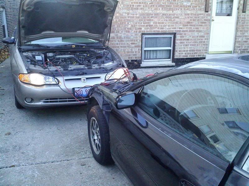

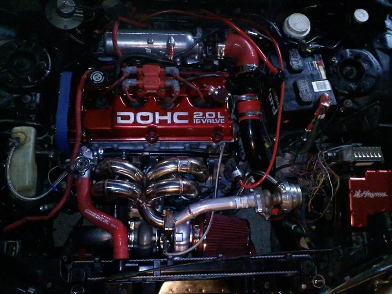

david-b
11-01-2009, 07:35 PM
AND SHE STARTS!!!
Got to the garage early today to work on her. Yesterday when I pressurized the fuel system, it started leaking at the rail. The rail I used was cracked, but I had JB welded it up and did a damn good job of it. Apparently not enough though. Thought that was going to be a process in it's self, to get the rail out and swap everything to a spare I had. Not too bad at all. Took out the hacked FPR off the leaky rail and installed in spare and injectors all swapped over. Took like 30min, not bad at all.
I filled her up with oil, sadly, she leaked at the oil pan. I have a crank scrapper with 2 gaskets in there and apparently it didnt seal right. For now, I took the crank scrapper out and just have the gasket. No leaks there now.
After more fuel leaks and a SS fitting that broke (WTF!), she was ready to go.
Jason and I went over the MSnS settings and everything was good, so went to start the car and had no luck. Battery was dead. Using jumpers and my parents car to jump and would crank, but not fire. I had no spark. After much testing, Jason recommended wiring up the coil back to the stock ECU, and she fired up.
The front motor mount is not installed yet in case I had more leaks so the motor had a good amount of movement in it. Also just sounded weird on top of a very rough idle. Also have exhaust leak somewhere at/around the manifold. I kept shutting her off as the roughness was making me nervous. Also had some minor leaks around, like the turbo feed line. I didn't rev her or anything. All I know, is that the garage was SMOKED up after she ran for a little bit. Foggy as all hell.
I didn't take too many pics today, but I got these 2.
Waiting on the driveway waiting to get started.
http://i59.photobucket.com/albums/g291/david-b/Motor%20Build/1101091303Medium.jpg
Jumping off Monte Carlo PLUS 2 battery jumpers. I should injest in an actual battery charger.
http://i59.photobucket.com/albums/g291/david-b/Motor%20Build/1101091508Medium.jpg

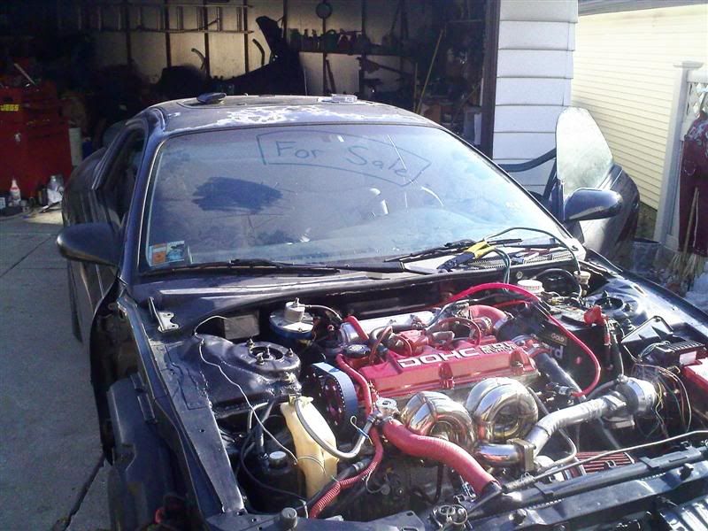

Made it out there today (wasn't supposed to) but made the time. After doing some minor fixes from yesterday, I started her up and she was still having some issues. It was night and had a light shining in the bay, and you can see the smoke rising up from it. Mad exhaust leaks. So I'm working on fixing those. Each fix I do, thing runs a little bit better. That manifold is a pain in the ass.
Also seems like I have leaks somewhere around the IM or throttle body. I can hear it, but was more focused on the exhaust.
Wanted to get video, but she's not video worthy yet.
And since everyone loves pics...
http://i59.photobucket.com/albums/g291/david-b/Motor%20Build/1102092037aMedium.jpg

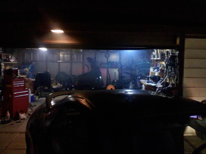

11-05-2009, 10:26 PM
Did some work today. Was trying to get the FP down. At idle, the car would just spit fuel out the exhaust. Revving would smoke up the entire garage hardcore.
For some reason, at idle, the thing was reading about 100psi at idle. I thought the gauge wiring was bad or something and no matter what I did, it kept reading that, but doing a little bouncing. I lowered the SFMU a couple turns and got it down to 35psi at idle. Near perfect for now. However, AFR was still at 10.0-10.9. Can't get that shit to lean out at all. Idle is smoother and it revs up a lot smoother now. But still choppy and rough more than not.
So I was playing around with it with one of my buddies making some changes here and there and doing some light revving. I got a coolant leak at that damn thermostat now. It was smoking from the turbine on the turbo, and had some oil leaking off the oil return line. Was still ok though. And then, I revved some more another time around, and it made a noise, and got some more smoke. I immediatly cut it off. I have no idea what it was, but it didn't sound good. I had checked for oil a little earlier and it was decent amount still. Didn't check after the noise tho. I called it quits for the day. I'm going to go back Satuday and try to see what happened.
I hope FOR THE LOVE OF GOD that nothing is f-ed up. I will not be happy and will instantly part the car out. Don't believe me... wait til Saturday.
The only pic tonight was the cloudy garage
http://i59.photobucket.com/albums/g291/david-b/Motor%20Build/1105091955aMedium.jpg

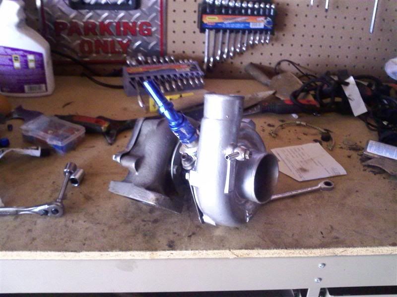

david-b
11-07-2009, 05:25 PM
Car is not for sale or being parted out (at least not yet ;) )
Early morning... how I felt
http://i59.photobucket.com/albums/g291/david-b/Motor%20Build/1107090924Medium.jpg
I drain all the oil and coolant from the car before I did anything. Checked for mixture (looks ok I guess) and coolant was good. I made some minor changes with some vac lines. Bought new MAP sensor and installed that. MS getting a much better reading with the new MAP now.
Got it started and NO NOISE. I checked everything over and was still running super rich. I pulled the filter off the turbo and realized that it wasn't spinning. If you look at the previous pics, the oil feed line basically has a 90* kink in it... which I think is starving the turbo of oil.
I pulled it off and got it all spinning again. Was wedged good. No play or anything.
http://i59.photobucket.com/albums/g291/david-b/Motor%20Build/1107091338aMedium.jpg
Installed back on... started it, and same issue. Locked right back up. So I'm going to get a new fitting so it feed line fits better. Hope that's the problem.

david-b
11-08-2009, 08:33 AM
Ya it just stops spinning. After i got it back together i kept spinning the turbine and it was fine. No play or anything. I gave is a little tug here and there and it spun fine. I turn the car on and it stops. I broke it free by turning the shaft with a socket. Now spins fine again.

Went to the garage this evening. I love Summit Racing. Ordered fittings on Sunday, arrived today standard shipping.
I installed the 90* fitting on the oil feed and started her up to see if it would spin, and sure enough she's spinning strong now. Granted I didn't run her for too long since I was in the garage and was being smoked out like a bee's hive, but she spins.

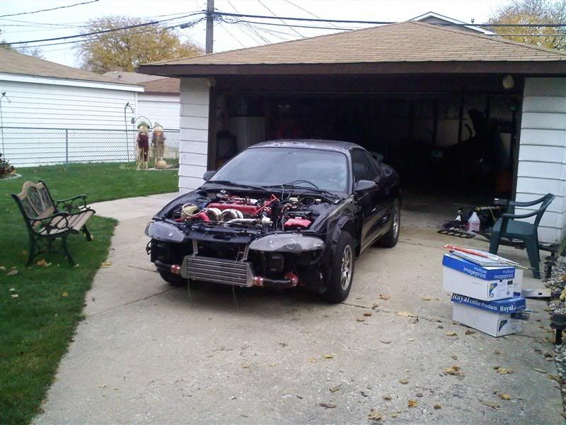

Installed panels and hood today. Have to trim, up the bumper more because the IC piping moved, so the old cuts don't match up anymore. PLUS, the hood has to be trimmed. Once of the braces sits right on top of the manifold causing it not to close all the way on the passenger side. Wasn't too happy about that, but not a big deal. Just going to grind down the one brace.
Then have a small coolant leak and not sure where... looks like its dripping by the back of the block, so picking her up this weekend and seeing where that's coming from. Maybe the drain plug isn't in all the way or something. And still running stupid rich.
Looking like a car again!
