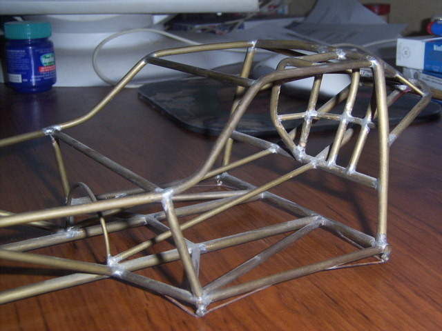

Hi everyone,hope you'll bare with me a while here. I started this a long
time ago,only recently dug it out again to have a break from the smaller ones.It's been a passion and a labour of love to do this, and try and get it right.
There's to be lots (about 90%)of scratch building on this one, it's not something I took on lightly,I pretty much have it all planned out now,
just have to pull it off
I have one of the Parma 1/10th scale Hemi's,which I hoped would make it in,but it's just too large ,...so,as you can see,I've started scaling it down to 1/12 and making my own.Multiplying the sizes by 10,devideing by 12..
The chassis is brass tube,soon to be updated to a more modern style,
all the suspension componants to be made,wheels....possibly modified
kit peices,not sure..
This WILL take a while,hope not too many get bored if the progress slows...........please be patient,I hope you enjoy
Here's a start...........

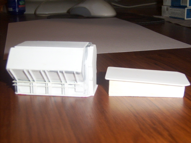

Small update
Hey guys,thanks for the interest and encouragement
Done a bit more to the motor,in between TAFE studies
Sorry about the post a day Pman,don't think I'll manage
Anyway,nuff talk,hears the prog.
Smaller motor is 1/24th Top Fuel,similar to what I need to do..
Made the sump tonight..

1/12th versus 1/24th
Thanks guys,just a couple of shots to compare sizes (Pille)

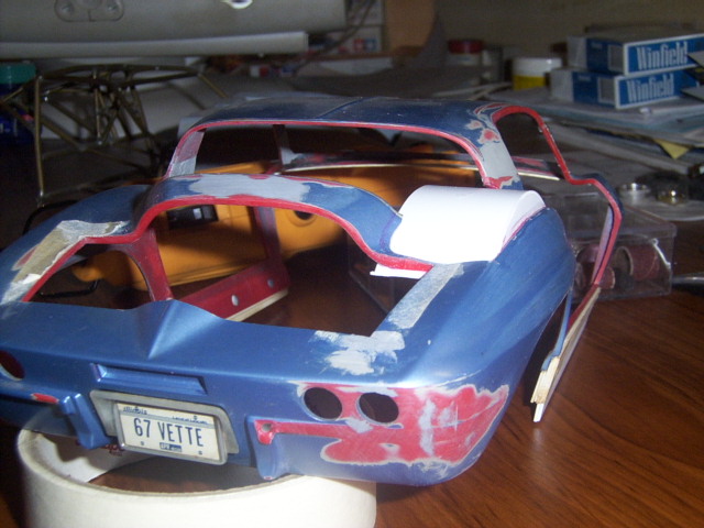

And the chassis Octagon,yeah,I'll be redoing it to more closely resemble what a few guys are using here in Aus..Probably same/similar to the U.S
I'd think.
Here's the pics...

Very Nice! Are you soldering the tubes together?
