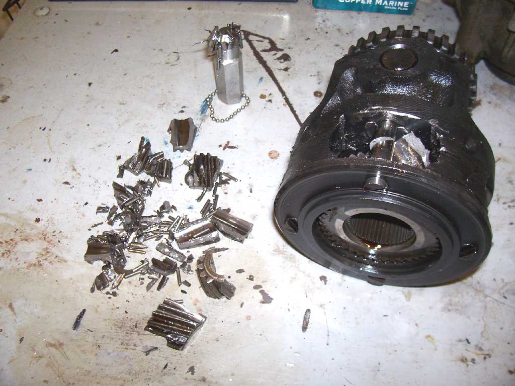

Don't be too surprised if the shop hands you a bag full of this:
The differential in this series transmission is a weak point, along with a few of the shafts. I do my own transmission repairs, and this one took about $480 out of my wallet in parts alone. $2,500 may be a little on the high side. Around this part of the midwest I can get an exchange/guaranteed 4T65E installed for about $1,750.
Adequate lubrication is critical. A jCat pointed out, the correct oil and filter and oil maintenance is crucial. Use Dexron VI or an equivalent only, even though Dexron III was originally approved for your transmission. The synthetic blend is superior to the Dex III and is probably worth the slight additional cost. The differential is cooled/lubricated/cleaned by oil flow through a tube in the pan, and this must be kept clean and unobstructed.
