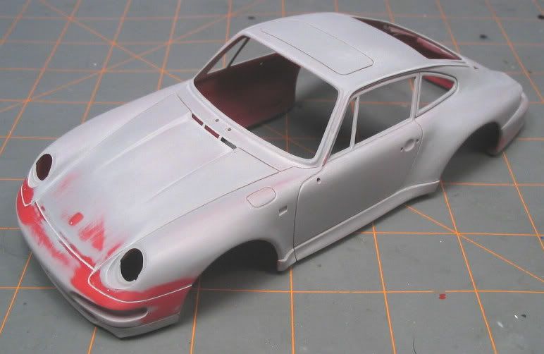

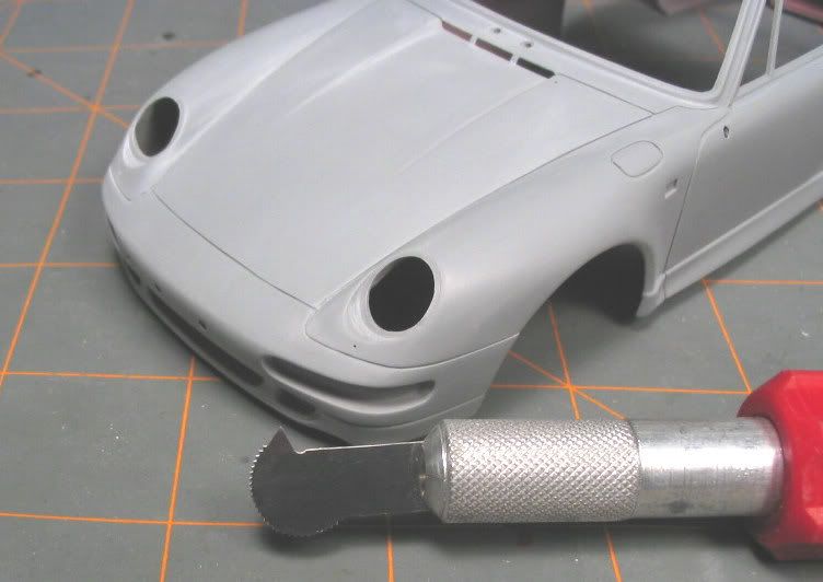

Once again, this build starts with bodywork and alot of primer.
The big challenge on this body is the nose. It's molded as a separate part from the rest of the body, and it was split off along the panel lines.
The 993 of course has very even (German car!) yet rather prominent panel lines- and a glued up seam just wasn't going to represent this well. So the nose was glued on, and the adjacent surfaces vigourously worked over with sanding sticks to even them out. The seam lines then had to be carefully engraved in with a PE scraper/saw. (The little grey spots under the headlights and at the Porsche badge are small guidance holes I drilled. Later they will help me locate the headlight washers and Porsche shield decal.)
No small amount of work, especially as the geometry of the lines below the headlights is rather complicated.
Here it's starting to look pretty good- but there's a bit of a pit at the T corner by the right headlight. This had to be filled with CA, reprimed and rescribed.

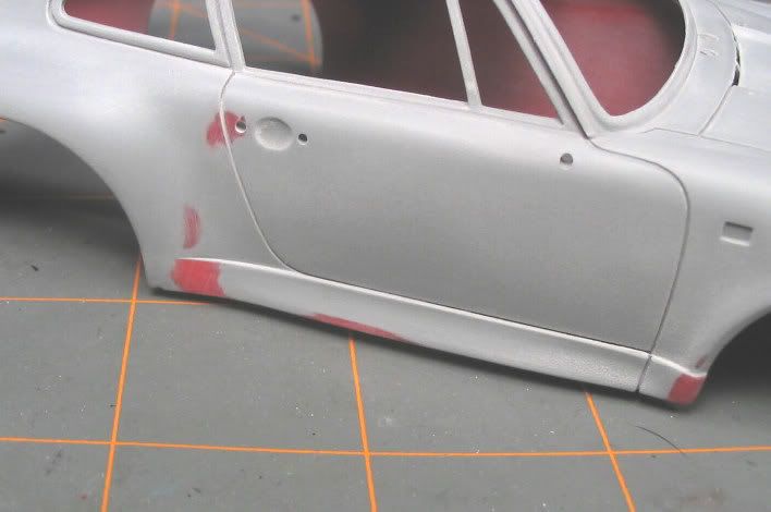

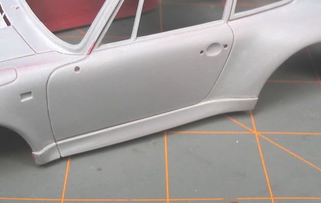

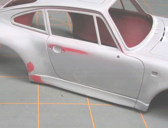

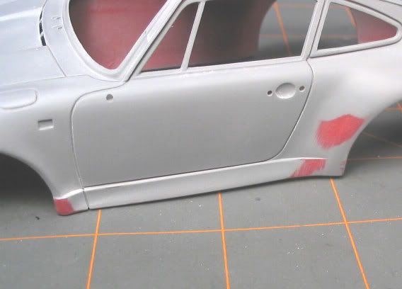

The side skirts were next.
Revell provides this detail as separate parts to be glued onto the lower edges of the sides. In studying pics of full scale 993s, I noticed that the rear edge of this seam blends ito the wheel arch- on the car it's not actually a seperate part at all. So back to fill, sand, prime, inspect, and repeat.
Took a little work, but finally they blended nicely with the wheel arches.

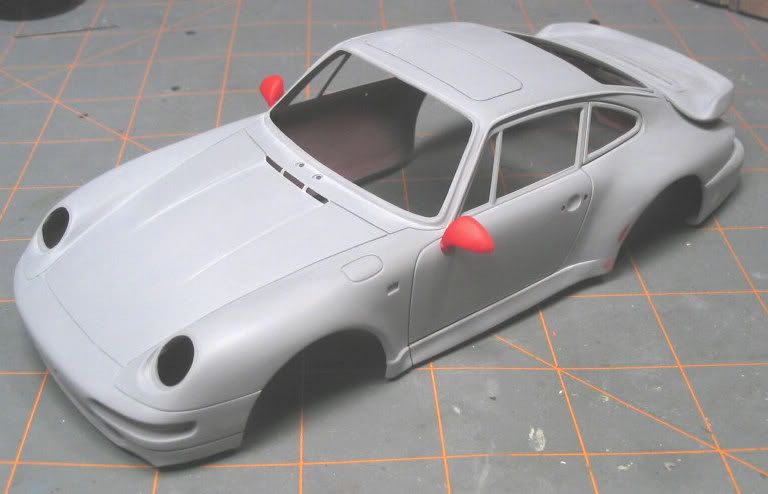

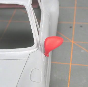

And the last major issue was the wing mirrors.

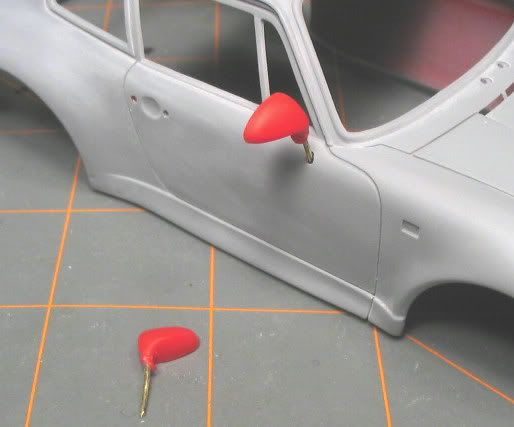

The mirror pod stalks didn't really fit against the body. This is definately the sort of thing you want to catch before painting.
Each stalk had it's mounting pin removed, and was drilled out to accept a length of brass rod. The angle of the stalk mounting pads were corrected by filing them to shape, and new corresponding holes were drilled downwards in the doors for the rods to fit into.
Done, now they just need primer.

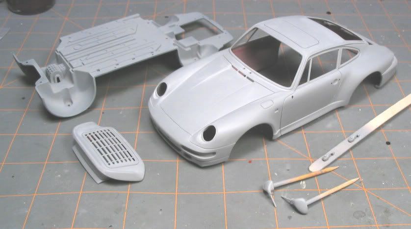

Here it all is ready for paint. I've been kind of working on this one in parallel with the 850- and so of course it got caught in the same painting weather holdup as the 850. But meanwhile there is other stuff to be working on....

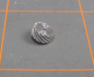

Anyone want to guess what this will be?

as for that pic:
it took me a while at first but Holy Hell!
I thought it was a drill/lathe bit at first but all I can say is wow.
Y'know, I'm expecting you to machine proper sized 993 Turbo wheels now; if only because I would like a set.

I'm going to guess its the beginnings of the engine fan? I've been in Porsche mode for the last few months so I think thats what that part will become.

Got it! It's the hub for the cooling fan. (Someone else suggested it was 6th gear for a Getrag box. ) I'll try to post some pics of the fan and housing soon as I get the chance. I figured it would take another Porsche fan to get it.

Did you measure where the sideskirt would fully blend with the body, to make them even from side to side, or did you just eyeball it really well? Spots like that always look a little challenging to me, since I'm afraid of making them asymmetrical by mistake.

Very good starting point, my sir!
I would like to point out that you'd better trim the window rubbers on this little sportscar...
Also, the rear looks very 964-ish, shouldn't the lateral curve on the rear be curved a bit inwards instead of outwards?
