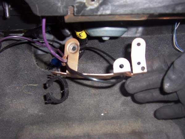

Other than the cramped space it is a DIY job. Move the passenger side seat back all the way. The blower motor is held up into the lower HVAC assembly by 3 bolts and there is a bracket with the vacuum lines. To access blower just remove passenger side kick panel. There is one electrical connector.
