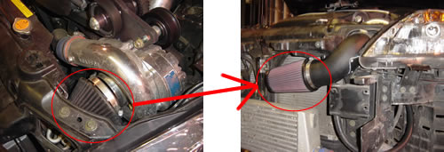

Intake piping in front of the supercharger was added to allow easy cleaning / replacement for the filter. Also, the Greddy EGT Warning gauge was installed, as it finally arrived. Some photographs from the installations are available in the AF 350Z 08/16/04 Gallery. Thank you Nick for great custom fabrication!

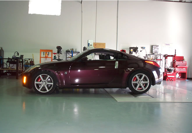

SR Racing will be helping us with the Vortech Supercharger installation and tuning. A baseline dyno pull was made on their SuperFlow SF-840 for comparative purposes. This dyno is capable of functioning inertially as well as an eddy current, which makes it a perfect tool for tuning. The baseline run yielded 255.2 rwhp @ 6167 RPM and 239.1 ft-lbs @ 4697 RPM. Admittedly, it was a bit silly to make another dyno run as we had recently gone to Clemons Racing, but at the time we had no knowledge of SR Racing.

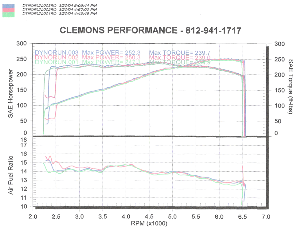

Today, the AF 350Z ventured 80 miles to get on a DynoJet dynamometer. Clemons Racing (New Albany, IN) were kind enough to let us use their facility. Josh Clemons himself, a NASCAR Busch Series driver (Car #41) helped with the dyno! Thank you Josh and good luck with your season!The results: We did 3 runs total, and each run was stronger than the previous. Due to the 80 mile drive on the highway, the car was extremely hot. As the runs were made, the car was still getting colder, stimulated by a fan and long cooldown periods. The top dyno shows 252.3 HP and 239.7 FT-LBS of torque. We suspect that the lack of backpressure due to the XERD headers and Borla true dual exhaust pair, 350Z's stock ECU overreacting to the higher than expected airflow, and newly installed StopTech 14.1" rotors (which are significantly heavier than the stock 11.5" rotors) are factors contributing to these numbers. These issues will be resolved by a supercharger and a standalone engine management system.

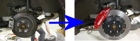

The AF 350Z has been rescued of its recent braking struggle due to worn out pads with an upgrade to StopTech's Big Brake Kit. The installation was done by William Taylor of Horsepower House in Lexington, KY. The kit features stainless steel braided lines, 14.1 inch slotted rotors, and wonderfully enormous red calipers. View the installation documentation here. These are the same brakes that are used by race teams around the world.

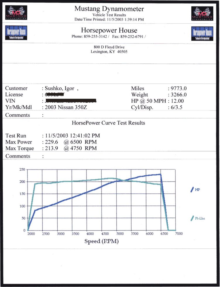

Baseline dyno runs were made on Horsepower House's All-Wheel Mustang Dynamometer. We got 229.6 HP @ 6500 RPM and 213.9 FT-LB @ 4750 RPM. All other 350Zs that we are aware of that were dynoed on Mustang Dyno or Dynodynamics Dyno produced an output of around 200whp. Both of the dynamometers mentioned above are of eddy current type, whose values are accepted as being around 15% below Dynojet numbers. With conservative calculations, the AF 350Z has over 300hp stock, which makes it a perfect candidate for heavy modification.
