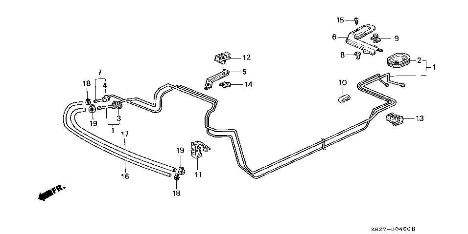

I dug up some tech diagrams I had, here are the ones for the JDM 1.5X Dual Carb CR-X, and for the Injected CR-X. As you can see there is quite a difference, and the crx ones will probably be shorter than for the Civic.
The carburetted 1.5X
The injected Si
Probably there only US people who can help would be the ones who have converted a Carburetted 1g CRX or 3g Civic to injection.
Or alternatively you could get the Carburettor, and an ECU from a JDM 1g teg with the Carbed DOHC ZC, but then you'l only have 120hp.
