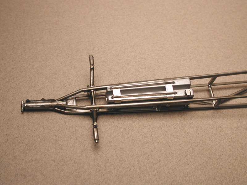

This is Cory's '05 car, not the one that broke in half last week. Big thanks to DaveT (skylinefan) for paving the way for both this car and the Brut car. If it wasn't for him working out all the kinks and showing me how a modern fuel car should be done I would have never been able to do these.
I started with the Bernstein kit, and cleaned up all the mold lines (a million of them) and then cut off the very front of the frame and reworked it to accomadate the single element front wing. Once it was ready, I primed it, shot it in Alclad Steel, and then hit all the weld joints with a combination of Alcald clear Amber, and Tamiya flat black. I added the fuel cell, and used the straps and hardware from a Garage Scenes PE sheet. I also installed the rear end center section.
