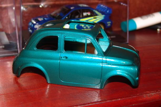

This is my first attempt using an airbrush (Iwata Revolution CR). The paint splatters somewhat. Is is too thick or is the compressor not strong enough? It's only 20psi. Feel free to critque and advise. BTW the kit will be OOB. I'm using it as a learning kit to spray so I won't detail it at all.

Give us more info, what paint were you spraying and what ratio did you thin it?

Tamiya metallica blue (X-13) and mixed it 50/50

You need more pressure to spray acrylics because they are heavier try 40-45 lbs.

With these acrylics you could thin it even more at the end of the painting session leaving you with almost pure thinner by the end. This will help you level out the paint as the thinner will dissolve the surface and if done right not let the paint run either. I've done my acrylics with as low as 25-30 psi without problems, just thin the paint more and put on more coats to build it up slowly.

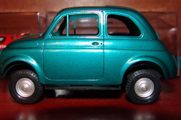

I've been a bit delayed on my update. I had a problem with my airbrush but I've fixed it now (I didn't clean it properly after my first usage! ).

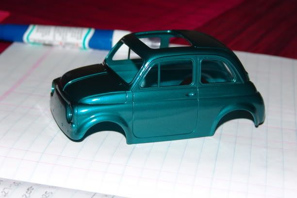

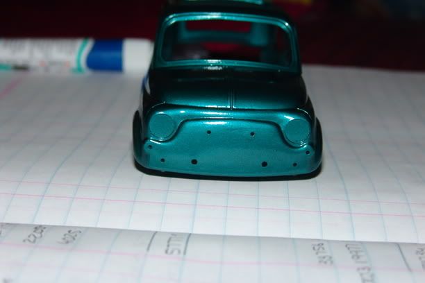

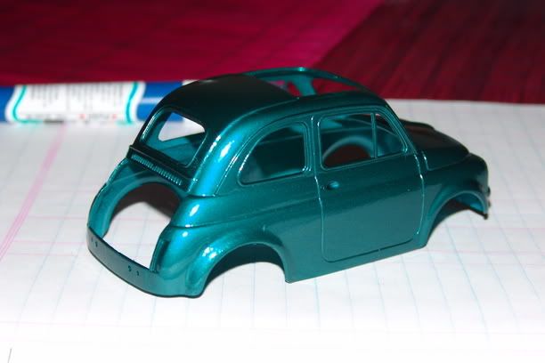

I tried thinning the paint a lot more (Thanks Niclas!) and this is the result. I think it looks OK except for the piece of dust that is sitting near the rear window!
I'll be using rubbing compound and seeing the effects of that are. Let me know what you think. Thanks again to everyone for the advice.

Well, it looked alright from the begining but now it's even better!
Glad that I could be of assistance.
Now let's see the finished car.
Take care and test the compound on a scrap piece first as some automotive stuff will make the paint go all soft and gum-like. Tamiyas compounds are safe to use on their acrylics though.

that paint looks great I wish my first airbrush attempt was that nice.
I'd say you have the hang of it so far. just remember, don't polish metalic paint. if you do the metalics will lay flat and look like crap. always use a clear over metalics before you polish.

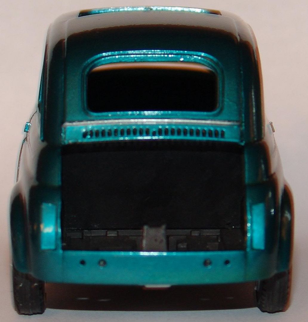

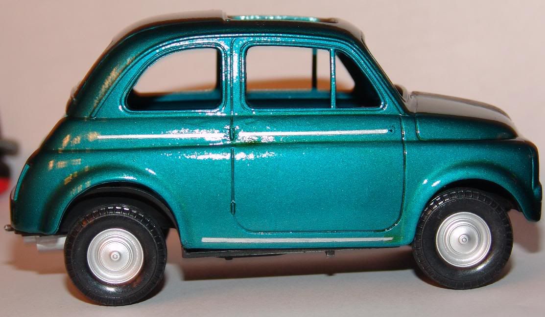

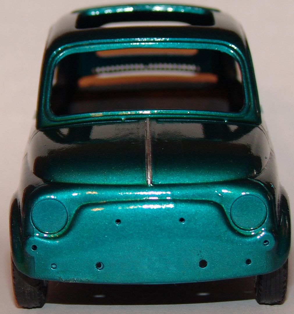

Finally an update!! Decided to customise this for a friend. She has one the same colour so I decided to mod the doors as suicide doors and added in the exposed hinges from an old credit card! I also tried masking for the first time and this was the result. Not great but I'm satisfied for a first attempt. Just need to finish some small detailing around the window frames before the last coat of clear and I'll then polish it up. Comments and criticisms are welcome!
