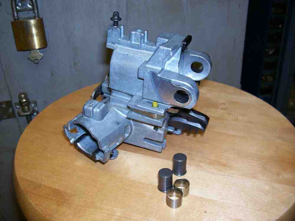

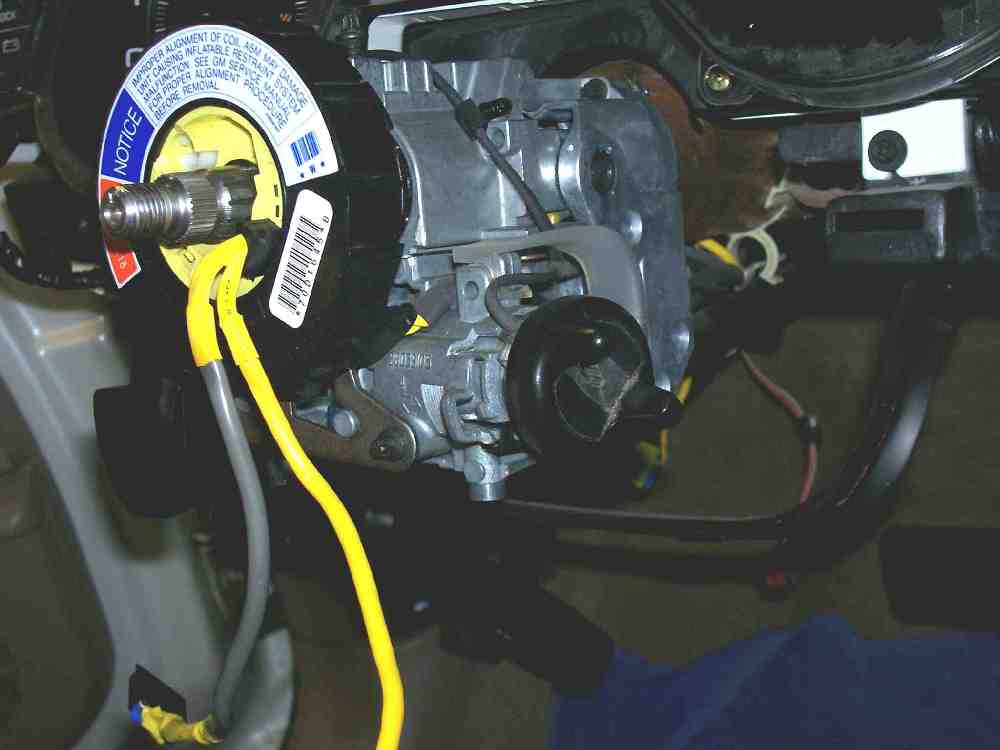

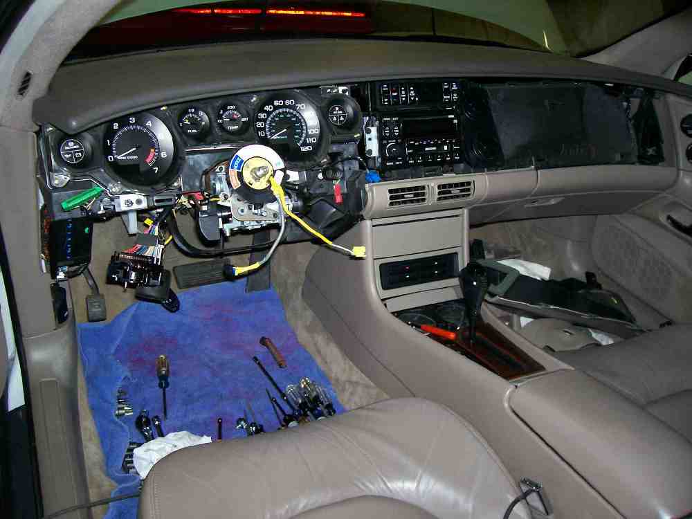

Been there. You'll have to dig into the dash,
Remove the upper column housing:
Manufacture some bushings:
Press them in place and reassemble:
There are few options on this type steering column.
