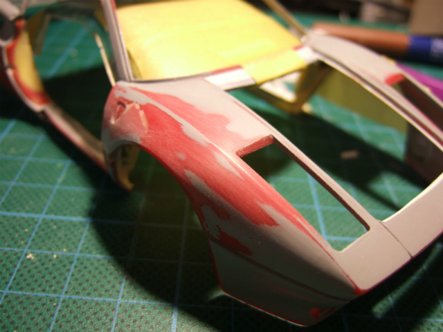

Putty was applied. Then sand up... yes, acceptable. Don't pursue the perfect.
I felt those driving light lenses are too big. To apply Fujimi's lenses, I put plastic board on the area and made the area smaller .
Rounded edges on front and back on doors
Before:
After:
(This photo is before the changing the shape of bonnet and light lids.)
The doors were sanded up to make straight line from front to back.
Can't see the deference...?
The loubers on front section was also removed. To check the deference, I spray the surfacer from time to time.

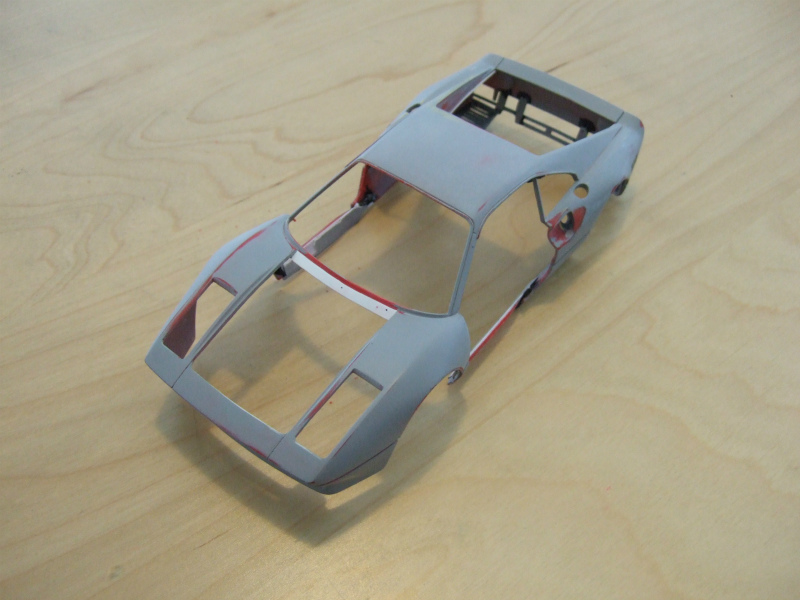

Quick post...
Edge up and gathering the body-color parts.
To edge-up, I put plastic strings and put the putty on, then sand up.
Some volume-ups on fenders. Yellow putty is Tamiya's epoxy, gray ones are normal putty. The ones which have the transparency are Tamiya's Light-curing putty, but I didn't like it. Because it's edges are easy to come off even if I sand the body before applying. In my point of view, I recommend epoxy and normal putty for these works..
Rear bumpers have to be removed, 'cause I don't like masking on this bumpy surface.
The gaps are filled and glued with plastic papers.
As mentioned already, front bonnet was removed. What a thick plastic body! Though this thickness strengthen the body. Yes, I like Revell's.
I think I'm too picky, but last section of front fender has to be this shape (I cut off the edge).
'cause I don't like the gaps on body, I cut this last section of chassis off.
Then glued to the body. Gaps are filled with putty (then sand up).

I want to express this; the hollow of the body for emblem.
I placed the PE emblem, then traced around by scraper.
Traced, traced and traced, then scraped inside by the rotary tool.
Considering the thickness of paint, the hollow was made a bit larger than the emblem.
The PE emblem was from MUSEUM COLLECTION, but I think many manufactures are making the same kinds.
And the front fender's lower part was reshaped as shown above... sorry, I didn't take the "before" picture. "Before" was too narrow on the bottom.
I filled the gaps between the body and the interior with plastic boards.
Then applied another board and reshaped.
OK, the the door fits in proper position.
I am happy with the straight line of the door as well.
The light covers are from Fujimi. The widths were narrowed and fitted.
I was afraid of this troublesome work... but I started on the door movable sections. This base part was cut and sanded out from a runner.
I made 2 types pf base, one has long hands and another has short hands to see how the door moves smoothly without hitting the body. In this case I chose the left one.
This picture shows how it works. The blue cord is just a temporary one, later on it'll be replaced to the brass rods.
The base was glued to the body.
The brass rods are removable so that I can take doors off when needed.
Hmmmm, it's cool!!

For the louvers on front fenders, I used 0.3mm plastic papers. Firstly I fixed the side ribs and marked 11 dots to fit the louvers (real GTO has 11 louvers) . I put the middle dot firstly, then other dots by freehand.
It went bumpy when I did this work in the evening. So I discard them all once and retried in the afternoon in the sun. We need sunshine, indeed.
Front bonnet. The curve for wipers are too wide, I realized. I applied 0.3mm plastic paper from the back then filled putty to narrow them.
The louvers. The same process as front fender's. But to make them a bit curvy, the width of louvers are just a bit wider than the bonnet's.
I am happy with the result.
