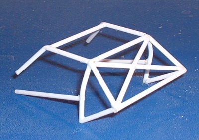

3/32" (2.4mm) diameter works best, I just used this size to build a rol cage for my Renault Megane kit.
I took a piece of roll cage from one of my Tamiya WRC kits to the hobby store and actually compared it to what they had there, this was the absolute nearest to the right size.
Building a roll cage this way takes a lot of time and patience though, make sure you measure plenty and test fit everything before you glue everything in its final place. Remember you're making it to mount on the chassis section but fit inside the body(at least I did) so you have to test it.
Good Luck
Ray
To give an idea of what can be done:
