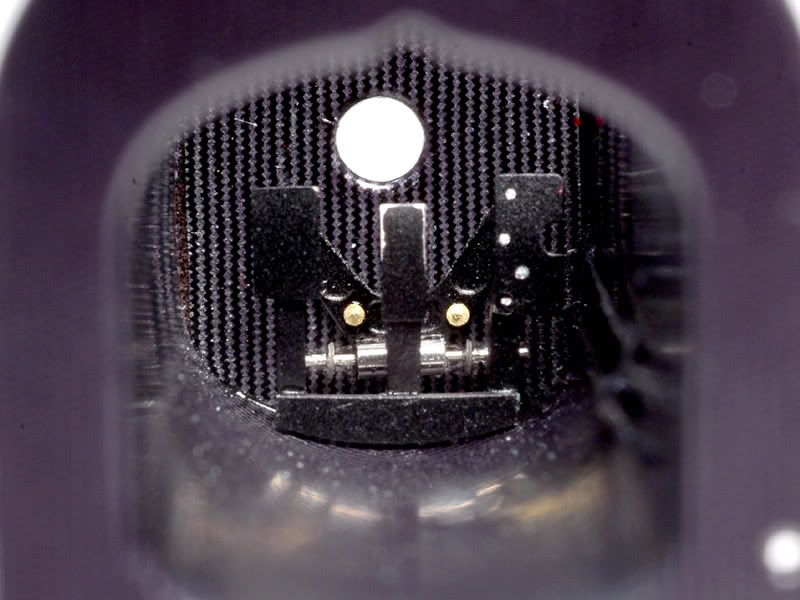

Here we go with some more bits and pieces. As I said in my last update I was fed up with sanding and polishing so I continued by working on the cockpit area. Some of the parts have been in the works or done for a while and others were now made during assembly.
The main two pieces for the footwell and seat area were CF’d and painted along with the bodywork. I scratch built the pedals even though they will hardly be visible in the end but you can see them when looking through the service hole in front of the front damper.
http://i21.photobucket.com/albums/b288/jaykay640/Jordan%20191/117pedalsinfootwell.jpg
There’s one useful picture in the Perfect Manual taken from the driver’s seat so I tried to build what I could see and made up the rest :-) I made them from some etched and plastic bits.
http://i21.photobucket.com/albums/b288/jaykay640/Jordan%20191/118pedalsfromseat.jpg

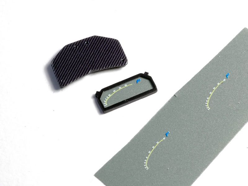

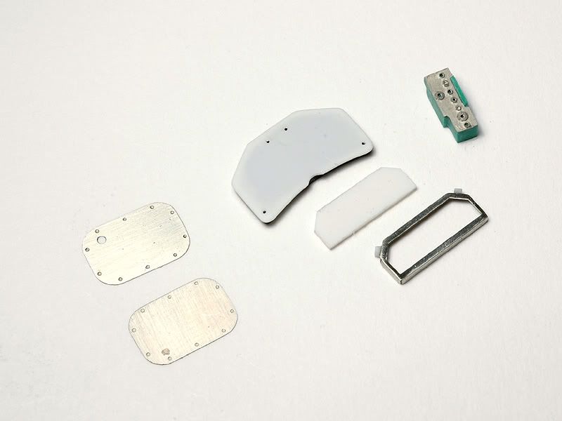

The next step was to do the main cockpit display. To replace the moulded in detail from the kit parts I made individual pieces from plastic for easier painting and decaling and an etched frame for the display itself.
In the picture you also see a switch box made from an etched front face and a bit of renshape that will go to the lower left of the “dashboard” and two etched panels that will go on the cockpit walls besides the driver’s shoulders.
http://i21.photobucket.com/albums/b288/jaykay640/Jordan%20191/119scratchbuiltcockpitdisplay.jpg
The parts were again painted and CF’d. For the display itself I designed the graphics ( that are printed/stickered on the real display as well ) along with the etching graphics and printed them on transparent overhead film with an ALPS printer. I then sprayed the film from the back side with a mix of moss green and silver. After cutting this out I could place the display face inside the etched frame.
http://i21.photobucket.com/albums/b288/jaykay640/Jordan%20191/120cockpitdisplay.jpg

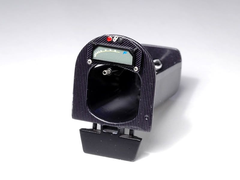

I then glued these parts on the dashboard and dressed them up with some small details. I also added the steering column that I made from brass tubes. The steering wheel that I’ll show later will be removable.
http://i21.photobucket.com/albums/b288/jaykay640/Jordan%20191/121displayinstalled.jpg
I carried on with the little box that goes to the left. It was also painted and CF’d. I then added the emergency button that I turned from aluminium and painted transparent red for the anodized look. The little switches were made from 0,3mm nickel silver wire. I tried to give them a bit of that typical conical shape but at that size it’s rather tricky. Anyway I’m happy how it turned out :-)
Finally I added some knee pads on the bulkhead, some wires and that little round thing between display and switch box that seems to be a later season addition. I have no clue what it’s for though :-)
http://i21.photobucket.com/albums/b288/jaykay640/Jordan%20191/122dashboardready.jpg

Then I installed the uprights with the brakeducts already glued on, followed by the driveshafts and upper suspension arms. It was quite tricky because there were a lot of ends coming together at the same time and at this point the fitment issues really started…
Anyway, for the record, the uprights are painted in a mix of matt enamel black and aluminium because enamel paint can give a rougher ( cast metal ) look than Zero when airbrushed at high pressure. The brakeducts received the same CF treatment that I previously described and were sanded and lightly polished ( and yes, it took ages to do them but I’m pretty proud about how they turned out :-) The driveshafts are painted Alclad Magnesium over a black base.
http://i21.photobucket.com/albums/b288/jaykay640/Jordan%20191/138upperrearsuspensionanduprightsin.jpg
Here’s a view of all parts assembled from the top rear. You can see that despite my efforts around the rear wing support things are not perfectly aligned but once the rear wing is in place this will be less visible :-)
http://i21.photobucket.com/albums/b288/jaykay640/Jordan%20191/139rearsuspensioninstalledtopview.jpg
Another view of one of the brake ducts. The CF pattern orientation is true to the real one :-)
http://i21.photobucket.com/albums/b288/jaykay640/Jordan%20191/140rearuprightsandbrakeductsfinishe.jpg
