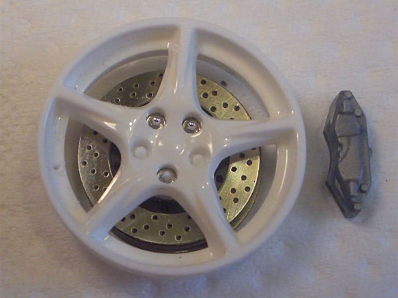

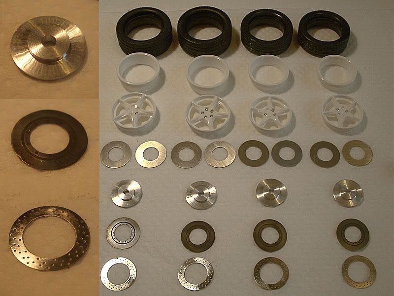

Some jobs on brakes: front and back side photoetched, inner part turned in alu. Front side polished with SM polishing sticks (3.2K+6K) and 2nd layer brunished with chemical brunisher (for german silver-alpacca). I though to cut out the horrible Revell system with double rims and replaced with 3mm rod.
http://i27.photobucket.com/albums/c159/gionc/brakes1.jpg
http://i27.photobucket.com/albums/c159/gionc/brakes2.jpg
http://i27.photobucket.com/albums/c159/gionc/brakes3.jpg

Yet again, here you and I go raising the bar on each other for the perfect set of brakes....

ok come on,speechless again,every time i checked this thread i was shocked,every steps you guys done are showing what's modeling at its best.i really love the disks!!all my respect buddy!:worshippy

I really like those brakes. Can you tell me why some of the lug nuts are chrome and the others are just plastic, are they being replaced or is that just kit chrome that didnt come off?
Mike.

Yep just chrome that didn't come off.

Gio, are you sure you don't want to strip the clear udercoat that Revell used under the chrome?

Yes Ales I already done with DOT after posting, thanks. Not easy job though.

OMFG!!! DOT!???!? :shakehead:shakehead:shakehead:shakehead:screwy::s crewy::screwy::screwy::eek::eek::eek::eek::disappo in:disappoin:disappoin:disappoin
Use alcohol!

There are better uses for alcohol, my friend! :D
Joking aside, I did find out by accident that denaturated spirit does strip that clear from Revell parts. Of course, so does DOT ;)

fantastic scratchbuilding on the brakes, now these shocks - superb!!!
