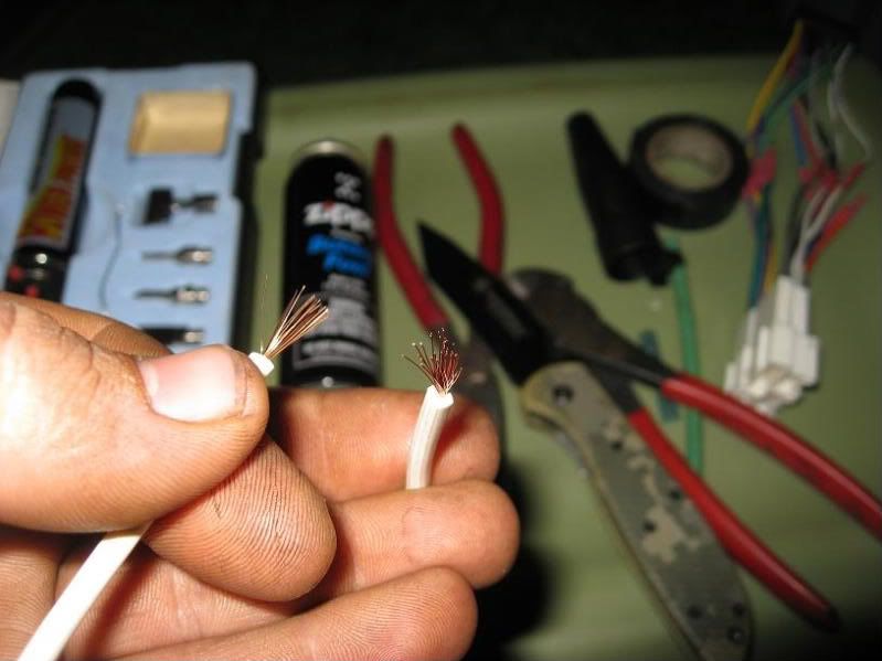

Here I am holding the wire, so far so good!
Using a sharp knife to cut the insulation and pull it off. Don't use a knife! Always use the proper tool.
The wires are stripped and the strands flared out slightly
Flared wires pushed together and flattened again.

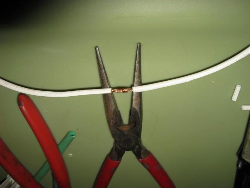

Ready to solder the wires together. Note that I am resting the wires on the open needle nose pliers. This will (hopefully) prevent my improper work surface (upside-down plastic storage container) from melting or catching on fire! If soldering inside a vehicle, have something on the carpet to protect it from possible damage. A damp rag has always been sufficient for me.
The wires are now soldered together. I couldn't take a picture of the actual soldering because I need both hands for that.

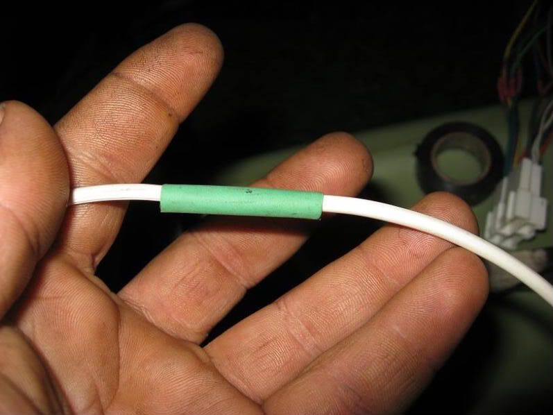

The heatshrink is in place. Remember to slide it at least 4" from the splice while soldering.
The heatshrink is now shrunk over the splice, keeping out any moisture that will cause corrosion.

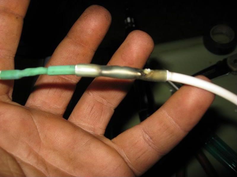

Insert the twisted strands into the butt-connector and crimp it using the crimping part of the wire strippers. Repeat with the other wire. I used pliers to "crimp" it, but I wouldn't trust that in a live circuit. Once you have both wires crimped, pull fairly hard to be sure the crimp is solid. You will be unable to pull the wires out if the crimp is good. If a wire pulls out, cut the connector out and try again.
Here it is crimped and shrunk. Notice the melted part on the right side. That's because lacking a heat gun, I used a lighter. An open flame is not good for shrinking the tubing. This particular one has two layers of heatshrink. The outer layer is just regular heatshrink, but there is a glue-like inner layer that melts and fills in any gaps, such as if you had two wires going in one side. That is what you should do if you ever need to "T" into a wire, DO NOT use scotchlok connectors, they damage the original wire and provide no protection from corrosion.
