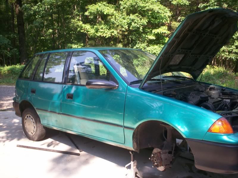

Just finished my clutch kit, flywheel & CV axle install on my 1993 Geo Metro a couple of weeks back. The car had other issues that I already knew about. Car misses at idle & drivning speed. Just put on new plugs, wires, cap & rotor, & O2 senson (all of this stuff was in bad shape to begin with). I did a compression check yesterday and saw the signs: These were dry readings.
#1 Cylinder-40 psi
#2 Cylinder-90 psi
#3 Cylinder-165 psi
At the very least it looks like I have some burnt valves. I have decided to go ahead and put new pistons, rings, rod bearings & gaskets on here in addition to sending the head to the machine shop.

Thanks for the info Doc! I found a complete gasket set (Head, intake, etc.) for about $50. I think I may go with the piston & ring set as well as rod bearing set from here.
http://www.store.partsdinosaur.com/page17.html
You did not do your mains is that correct?
Gonna be doing the Metro in the driveway like I did the clutch kit , etc.
Garage has my other long term Z28 Resto in pieces
I'll be rotating between the two of them in the next couple of weeks.

Took the head off last night. Sure enough two burnt exhaust valves of the two cylinders that had low compression. The EGR port is COMPLETELY clogged. On a side note, I BROKE the cheap assed valve cover after I tapped it with a rubber hammer. Gotta get another one of those. Cylinders looked outstanding. More updates coming soon

Took the pistons out yesterday. Bearings looked good. Pistons looked OK but I went ahead and bought new ones anyway. Parts come in on Monday. Gonna hone the cylinders tommorrow.
