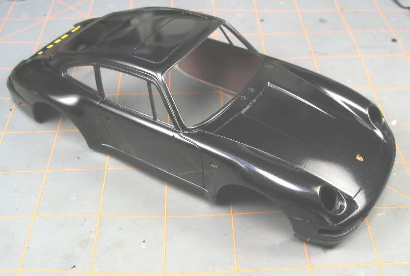

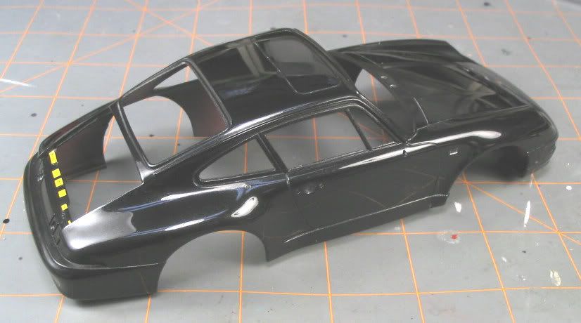

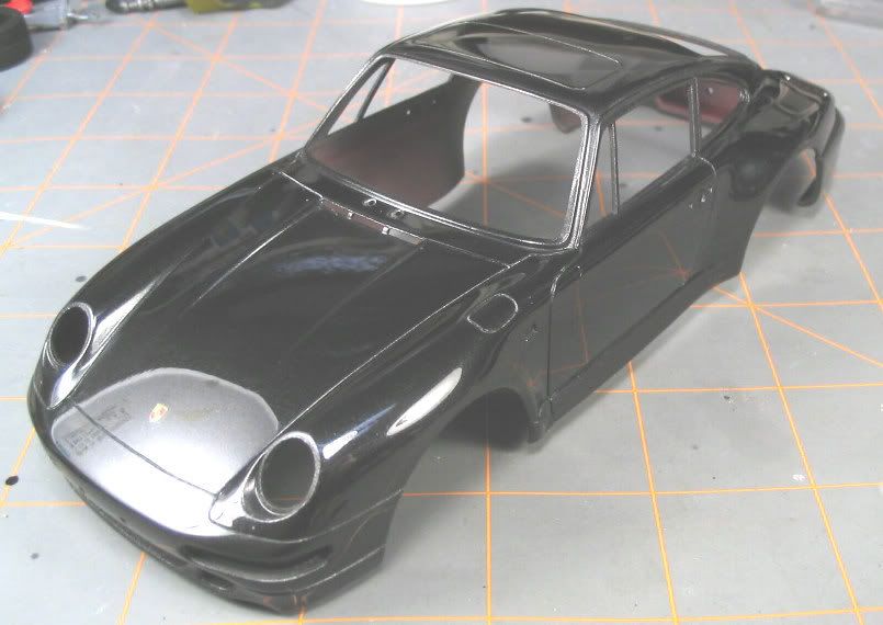

Well, I am no expert. But I have been working hard on my last several models to get a really nice final paint job.
I dont know if you are using an airbrush or cans. I use cans. And pretty much now only using Tamyia paints. I usually throw on a couple coats of primer. Sanding each one lightly. If the final primer coat is completly covering all the body, I then go for color.
On my latest model the final color coat came out pretty smooth. But even that it still needs sanding and polishing. I am using some Micro-mesh cloths from 3200-8000 grit. Then use the Tamyia polishing compounds (Course to Fine to Finish). This is giving me a very near perfect finish.
It takes some time to get used to using this stuff. The first couple bodies I used this on I would sand through on edges and raised details. But it just takes practice to learn how much is enough. I have read a lot of tutorials on line and although they help, nothing helps more than just doing it and learning how much to sand and polish out.
As far as OP under a clear-coat? I don't think I would do that. I would at least get some 2000 sandpaper and smooth the paint out then clear coat it. This would be no diff then clear coating a matte metallic paint. And the Clear works well for a gloss over it.
Here are a couple pics. This is my 64 impala I am working on now. The roof has been polished while the trunk/decklid is just as the paint was laid. It hasn't been sanded even yet. You can see the diff with what some sanding and polishing will do.
This is without a Clear coat. I decided to try just polishing out the paint this time.

very nice work there... the model im on now doesnt have severe orange peel...im just wondering whether its possible to achieve a COMPLETE, perfect mirror paint job without sanding, polishing etc...so basically is it posible to achieve the polished effect without doing so....
Looking into the above posters nice paint job, there still do seem to be very very minro orange peel after polishing...im not saying hes done a bad job...hes done great...in fact....i looked into my real car the other day and i noticed theres orange peel too lol...that was the stock factory paint job...untouched and theres still minor OP...but the shine is still there..
