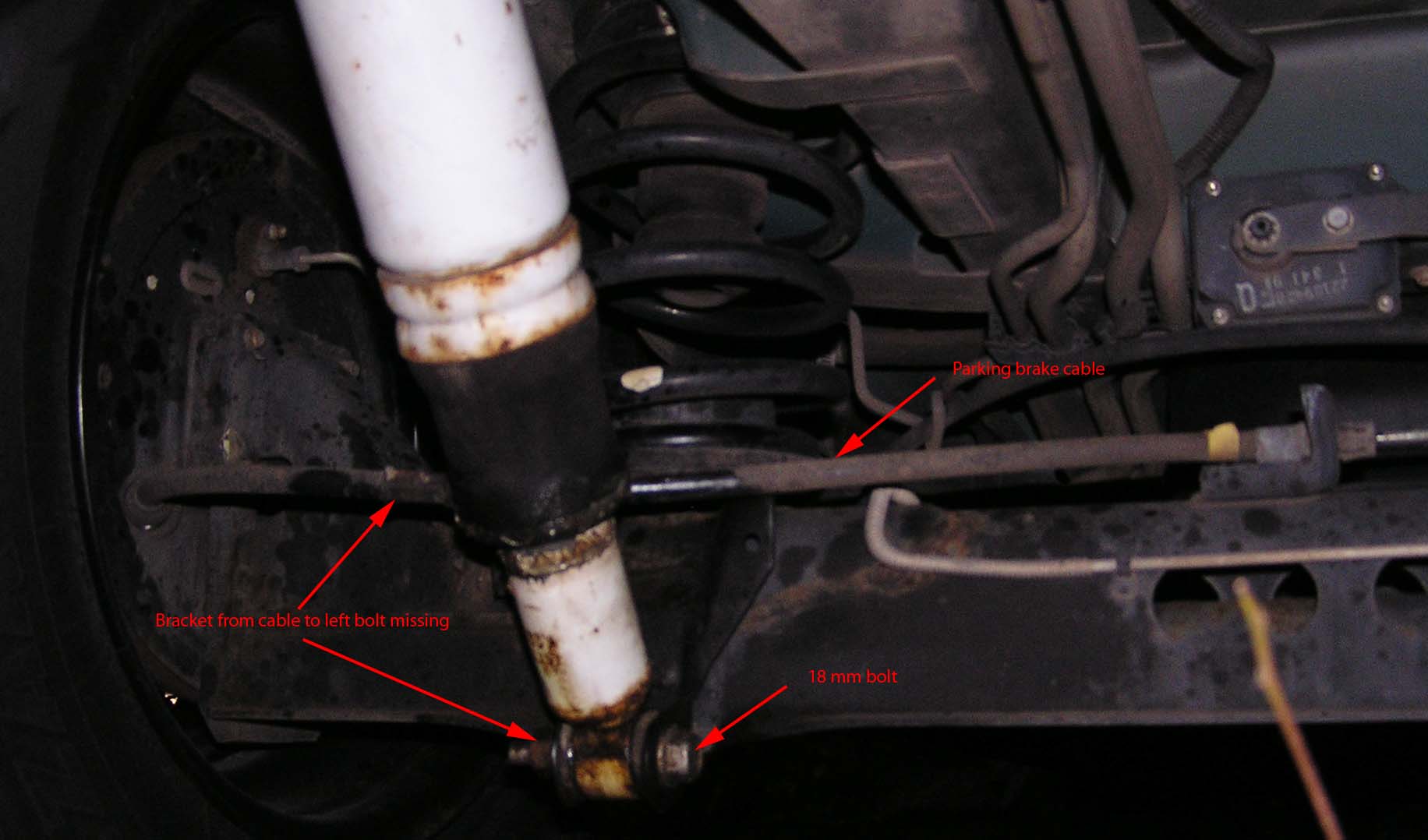

Looks like 18 mm. Haven't tried loosening the bolt yet. Looking at the driver's side rear strut I noticed that the parking brake cable was rubbing up against the strut. It looks like there is a bracket missing.
Here the bracket is shown in the Haynes manual.
Here is my rear strut.
Notice on the left, no bracket. Anyone know what this part would be or an online catalog with pictures. Thanks.
I went to my local Chevy dealer and they were able to provide the image:
Part#14 looks about the right place and name, Parking brake cable bracket. It doesn't quite look the same as the picture and there are left and right versions. I didn't notice the place on the cable for the right bracket.
