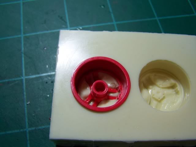

Ok Take you OG wheel (That's Original wheel) and put the Liquid Laytex Rubber in the wheel and fill it up.
I'm using an old resin wheel an mold to prop up the wheel and show how I did what I did.

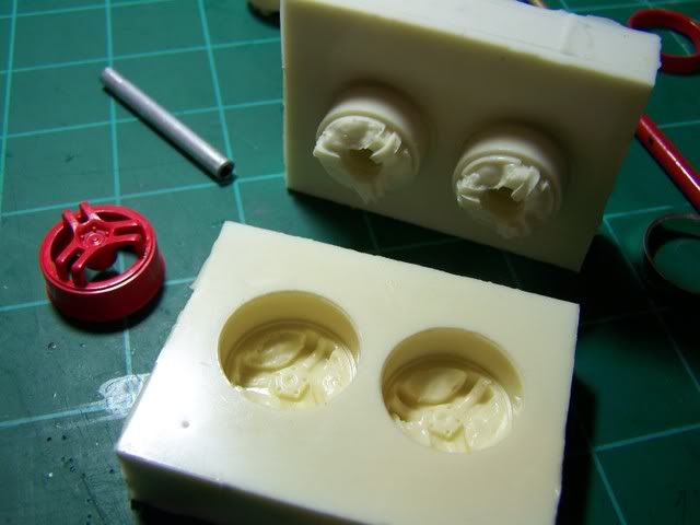

The red one is the OG wheel. once the wheel is full and dry, put some laytex under thewheel and place it on a flat spot and let dry. Ok now it's dry build your Lego box and mix up your RTV Silicone Rubber and pour it into the box. once that is dry pull up the first mold. It should look like this.

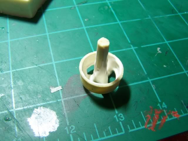

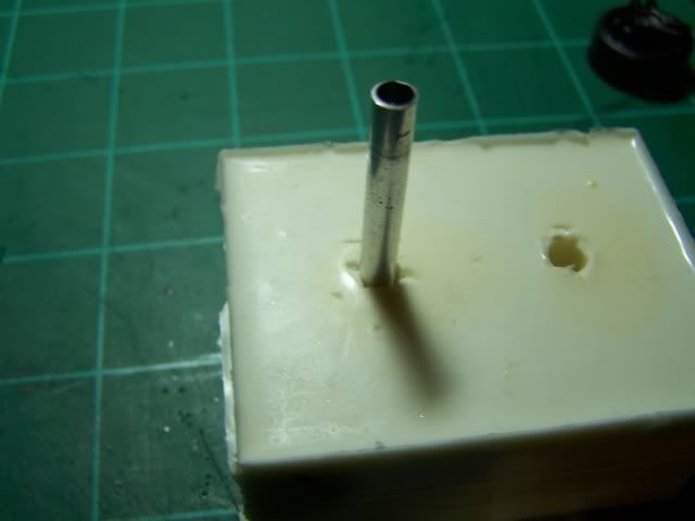

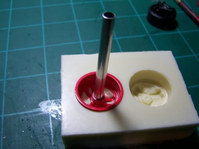

Ok now pull out the hard laytex rubber an put in your Alum. tubing to make the post. use a small drop of Laytex to hold it in place and let dry.

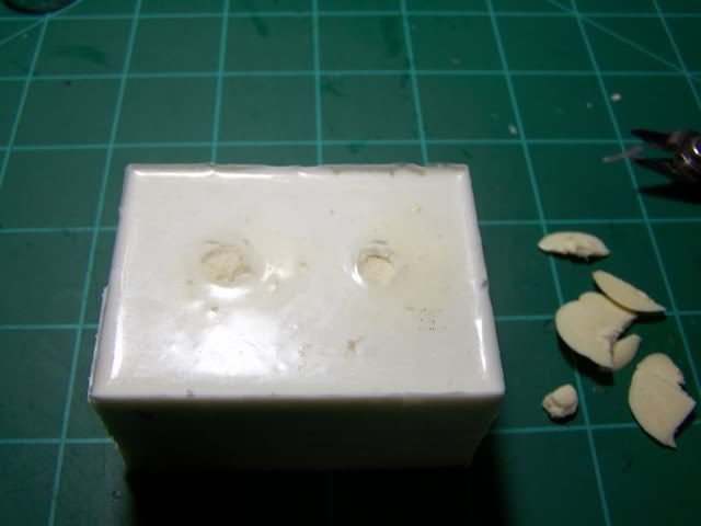

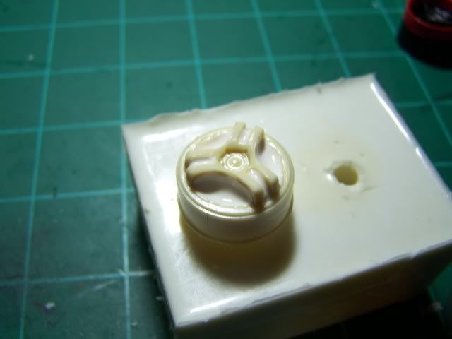

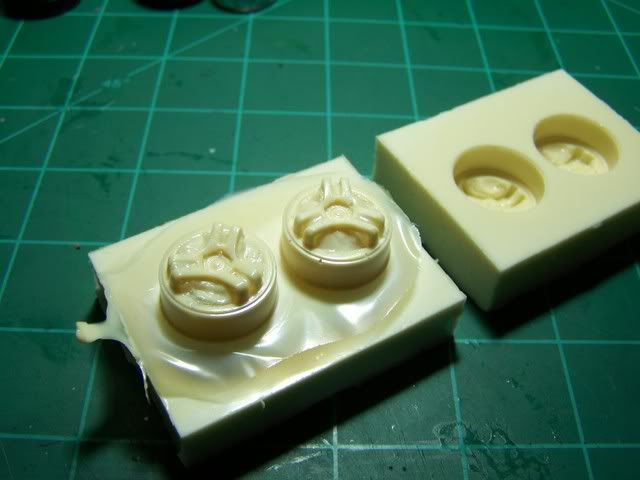

Ok now that's dry put on some more legos to make the 2nd part mold just be for you mix and pour use your Rubber to rubber Releasing agent. Just use a paint brush to put it on. All over the first mold and in side the wheel. This will keep your next pour from sticking to each othere. (Note This is for the first timers) Ok now that that is dry mix and pour on your next layer of RTV Silicone an let dry it should look like this.
Once that is dry pull out the tubbing and work,Wiggle,pull the two mold half's apart.

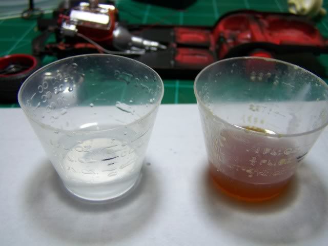

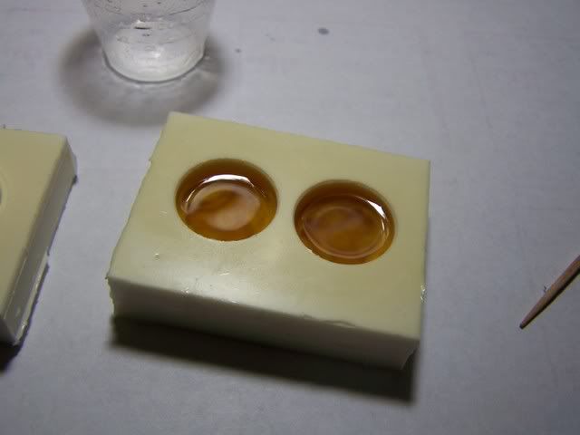

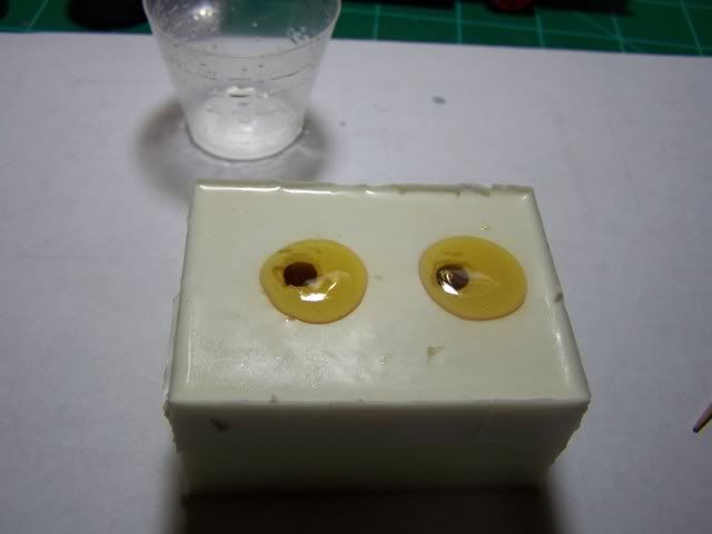

now get you mixing cups and pour up to Equal parts of resin and clear harder:

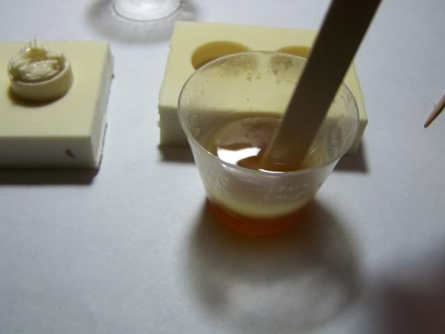

ok pour the clear in to the gold resin and mix (It's have to mix and take pix at the same time). Once you fill the cup getting hot it's time to pour. (Note if your using a long time ste you will not need the thing I say) Oh ya get out that tooth pic so you can work out the bubbles.
I had to work fast I use Quick set Resin.

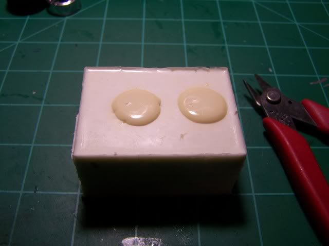

Ok now you have most of the bubbles out place the top on and let sit over night (for you long time caster) and for you all like me press and hold till the puddles that will form at top (Not you can see a lot of bubbles come out this way)

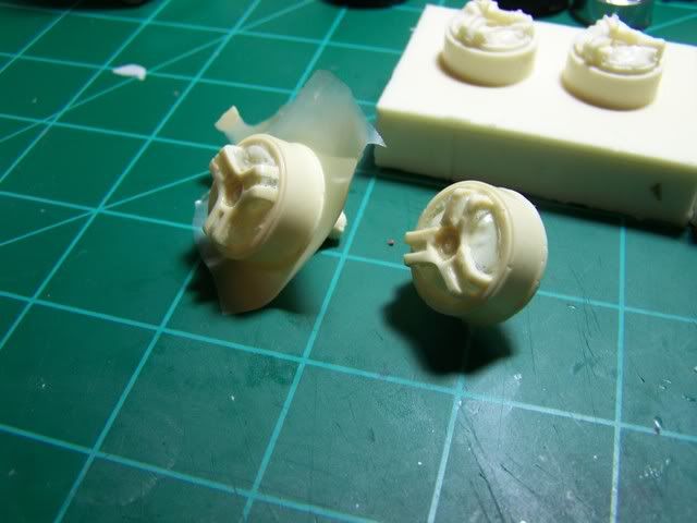

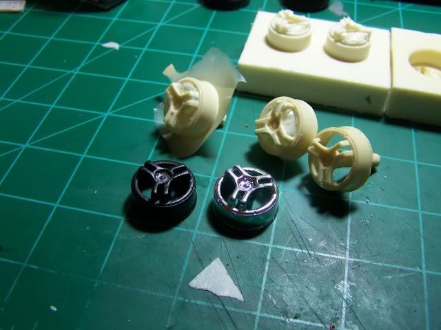

Now its dry and not hot to the touch. you can now start to cut of all that left over resin from the puddels. An work or wiggle the two parts apart.
Now trim the inside and out side of the wheel, and clean the wheels with Lacquer Thinner, let dry and paint them with primer if you need to(Note use primer if your goint to Chrome them).
Now what you all think of that.
Oh if any of you wan to sale any of your copys don't Copy Right Problems will come your way.
Oh and one mor thing to make a mole of the outer wheel you just nee to make a one sided moled. Remember to put some layetx under the wheel to keep them in place.
My fack wheel next to the real one.
