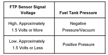

The next step since it doesn't cost much is to check the PCM 5 volt reference signal at the pressure sensor electrical connector which is wiring to include signals. Use a digital multimeter - DMM. The FTP sensor provides a low reference signal ouput based on pressure it senses between air pressure and vacuum in the evaporative emissions system. One parameter to set P0452 is the output of the sensor is .1 volts or less which is clearly abnormal and the abnormal condition is present for more than 5 seconds. The FTP sensor signal circuit voltage varies depending on EVAP system pressure or vacuum. See table below.
