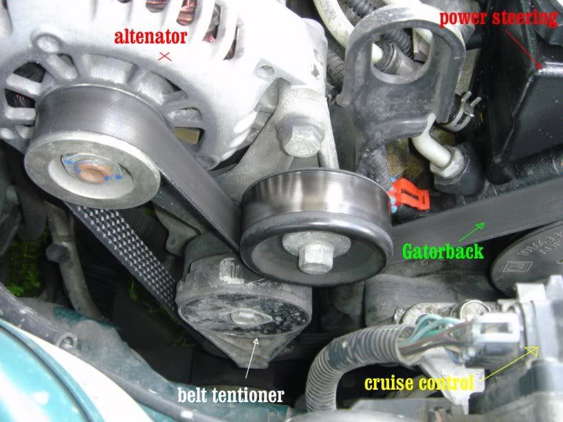

With those miles I'd suggest the fuel filter still(if you hadnt already).
If that doesnt work get the fuel pressure tested.
The shrader valve is on the pass side of the motor(should be capped),
between the power steering pump and the alternator.
Should be between 41-47psi , if not either your fuel pressure regulators bad.
You can by or rent a tool to test your fuel pressure from most parts stores.
this pic has the location of that vavle on the end of the fuel rail.
3.4 engine
Well you cant see the vavle,
its behind the engine lift brace(with the Oval hole in it).
1999 Grand Am SS 3.4 OHV
