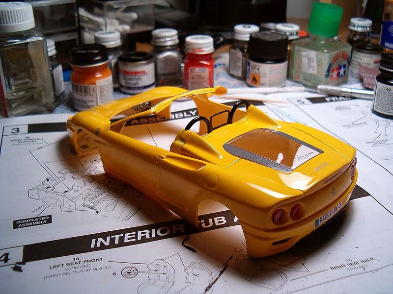

Ahh just started another project. Gotta love working on 2 Ferraris at once. Just painted the car. I must say that I hate not having a proper place for spraying, too much crap lands onto the body. Ill polish it off later.

Revell kit?
Is that Tamiya camel yellow?
Great progress!

yeah it's a revell, but testors yellow.

very cool is that testors yellow from their lacquer paints?

Just an enamel from a spray can.
Yeah the top part really makes me mad, such a simple thing to notice and yet they released a kit this way.

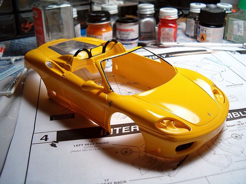

Cool stuff... It seems like the paint is very thick.. then again another side of me is telling me it isnt , as its suppose to look like this...

Not it actually isn't. I rubed the body with compound, and for some reason always on the edges I get the least amount of paint, so it sort of rubbed through to the primer. The only way my tamiya compound works is if I use clear coat right after, otherwise the whole car looks like crap - dull and scratched up. Maybe my compound is too old? I've had it for 3 years

Hmm if ur planning on using compound on paint before clearcoating i suggest rubbing close to but not on edges and lines of the body... usually the paint on lines and edges are the thinnest .. and try doing a wet sand with a high grit sand paper maybe around 2000 to 2500 apply light pressure then go over with a finishing compound to give it a mild shine... let the body dry for maybe 4 to 7 days then wash with water. Then you can start with the clearcoat... This should improve your final shine alot

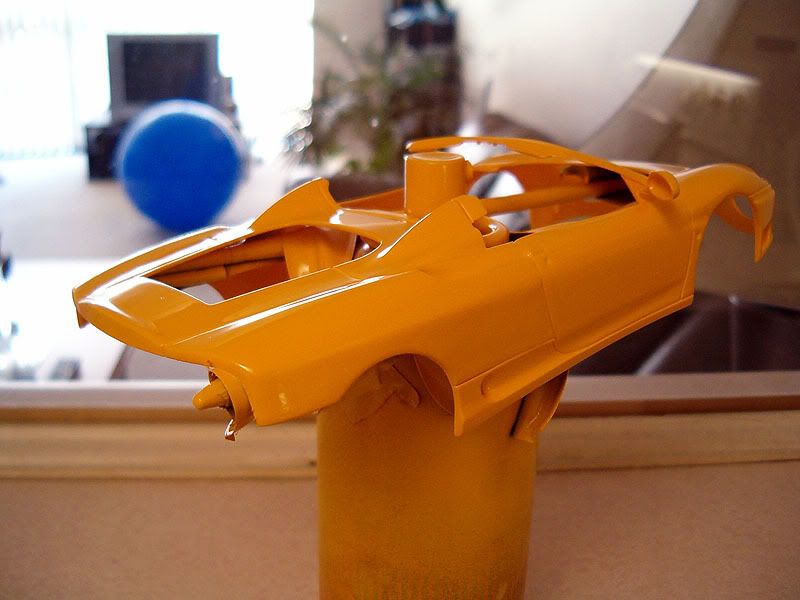

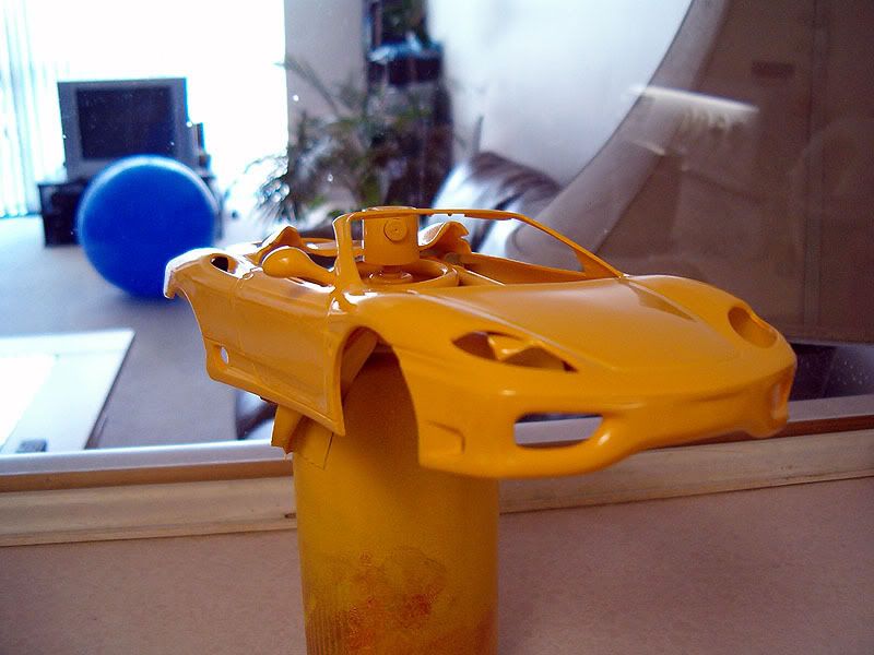

Here is a little update. Yellow paint is a real pain to work with. Also pictures hide a lot of imperfections. I think I am getting a hang of proper paint jobs, we will see how my enzo will turn out.
