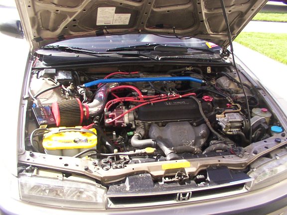

I don't have a CAI. I do have a Short Ram Intake. On my install the resonator box you speak of was not removed. On a CAI I would have believed that it would not be removed either. You pose a good question. My only suggestion would have been to change your battery position to the trunk. This would allow you a path to direct your CAI. The resonator box wouldn't be in the way in this case. I haven't seen a CAI for a 90 Accord yet. What brand is it? Maybe you could go to thier web site for installation instructions. Just a guess. Good luck on your install. Be is a pic of my SRI.
