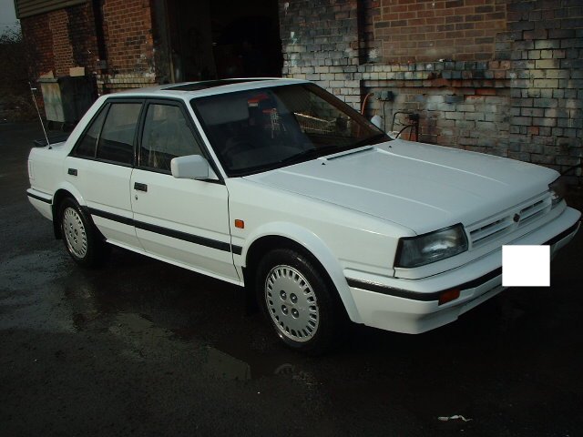

hehe.... you know me only too well Chris. I was VERY lucky, she saw the better side of having this Bluebird, cos i did just buy a 1.6 about 4 weeks ago, but that needed about £150 work done to it, and it was really bad on the juice, so i bought this for £350
Not bad is it. 124k miles, clean, good runner, full electric everything

Hmm, looks like a nice winter beater wait... my Primera is so stock that it's not a bad winter beater as well...
Now thats what I call damn good value !
