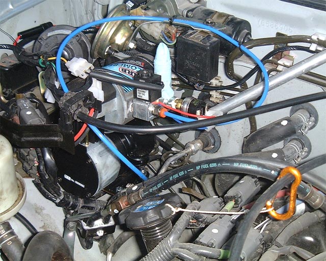

Here's one solution.
I thought that the gas cap problems were being fixed by a new valve cover under warranty? Hadn't heard about the two different caps.
That's a solution for losing the oil cap, not keeping it on the valve cover.
Yup. I never said I have all the answers. :licker: Just keeps it from falling on the trail.
