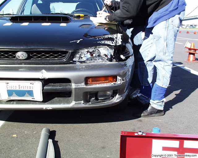

Tires. Period. Pick up a set of Bridgestone RE730s or Kumho Ecstas. This will be the best modification you can make early on. Then, go to autocrosses and track events to squeeze every ounce of power out of the car. Then, once you feel the need to go faster, don't. Upgrade your rear swaybar to 21mm or higher. This will be the second best modification you can make.
Then, go to more autocrosses and track events. After a year or so, then go with exhaust, pipes, etc. But trust me, the WRX has plenty of power. Go with handling mods first and then, once you can corner at the cars limits without killing yourself, start piling on the speed mods.
Here is what happens when you outdrive the crappy RE92s. So trust me on this. Tires are #1. Swaybar is #2. Suspension is #3. Then, intake/exhaust/pipes is #4.

hey trunkmonkey....do you work for Cisco?
