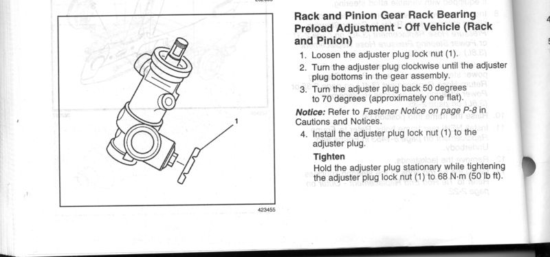

cant find anyone for tomorrow so I am going to use a bungee to hold up the boot and a digital camera on a small tripod. I am thinking it might be the raq joint of the intermediate shaft so I am going to also add audio queues for when I turn the wheel. I found this adjustment for removing play if it is the rack.
