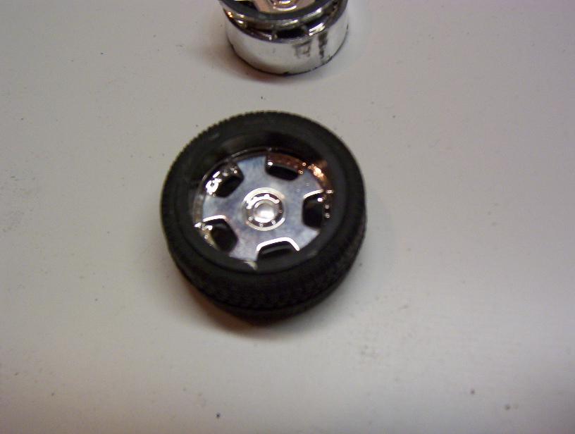

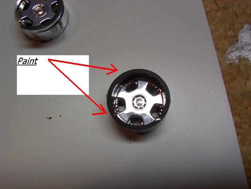

heres another way to make deep dish rims without having to waste another rim, or even buy styrene...
start off with the rim, and cut a small section from the rear of the rim.
Then, all you do is Sand down the new "lip", on both sides, then glue it onto the face of the rim.
THen you paint (which i haven't completed) and It SHOULD look great

thats the best way i have seen yet, and keeps the right depth for the tyre

Yeah, but wouldn't the wheels stick really far out from the side of the car?

Even if they did, You can shorten the suspension pieces to make it fit

The difference here is that you need a good cutting tool and very good control to make the cut straight and narrow enough. With the other methods, you could just sand away the backside of the rim.
What did you use for your cutting?

some hobby saw, which didn't work well with a vice..
i didn't think my dremel would work, meh
im going to go paint them.... ill take some pics soon!~
