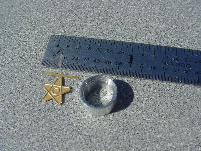

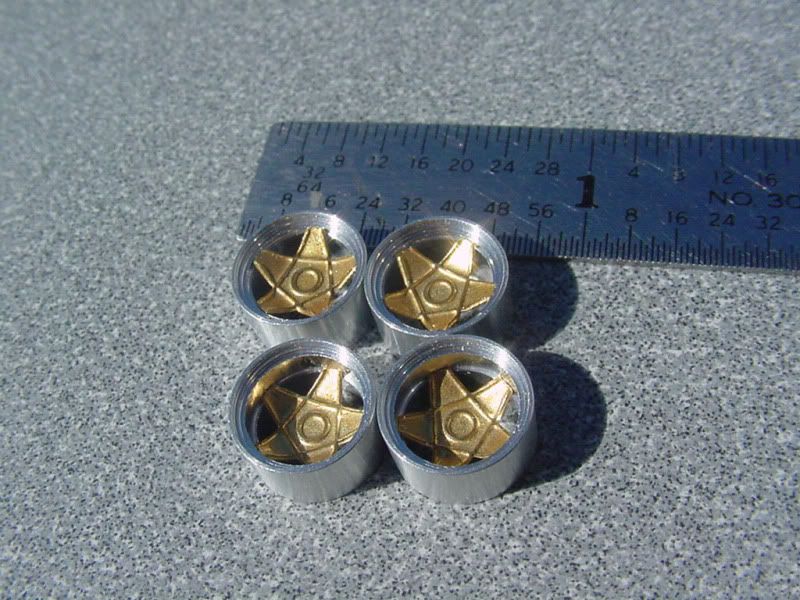

The wheels are PE brass and machined aluminum.
The centers had to be bowed to fit into the rim. I made a plug and pressed them to dish them uniformly.

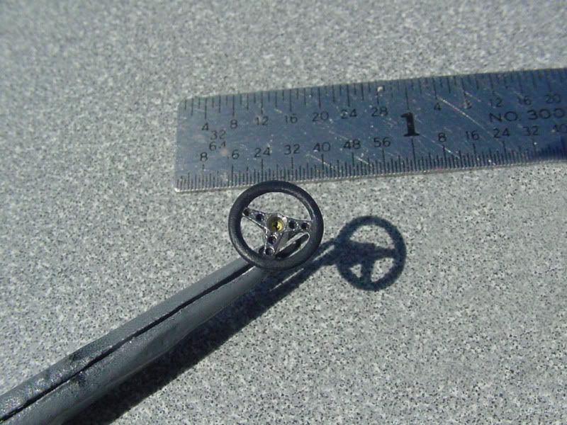

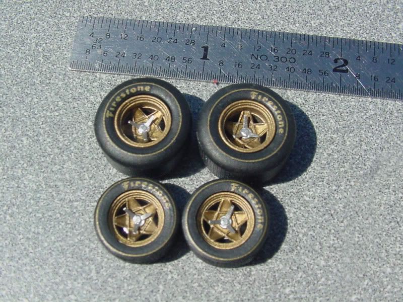

Wheels and tires are done, as is the steering wheel. It was cast with a horn button so I drilled it out to match the race car’s wheel.

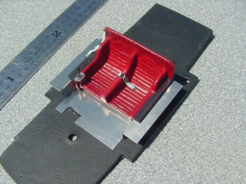

Seat is done. Real car’s upholstery is not leather but vinyl…

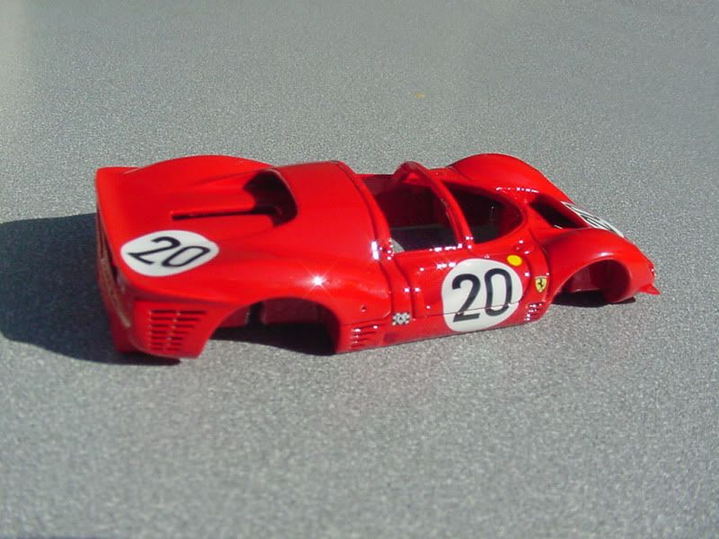

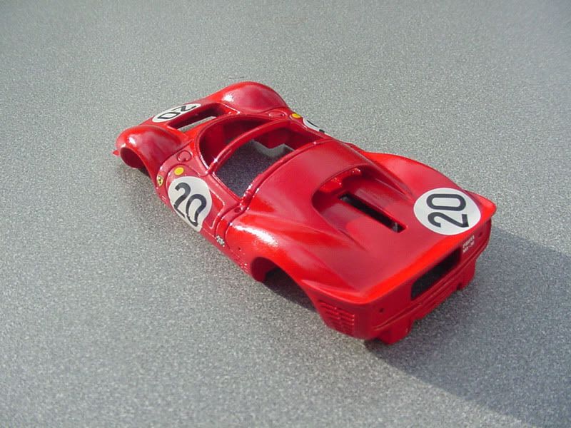

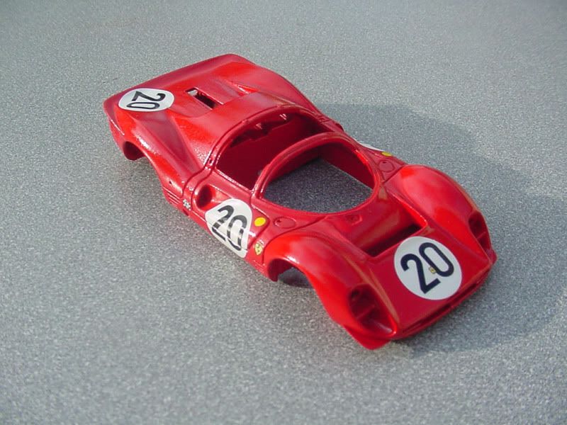

The body is resin (with a few PE detail parts) and needed some clean-up. The vent slots needed the most attention, and the front splitter was C shaped so I cut it out and replaced it with a stainless steel piece I made up.
Tamiya Italian Red was applied, as well as the decals…

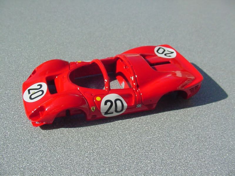

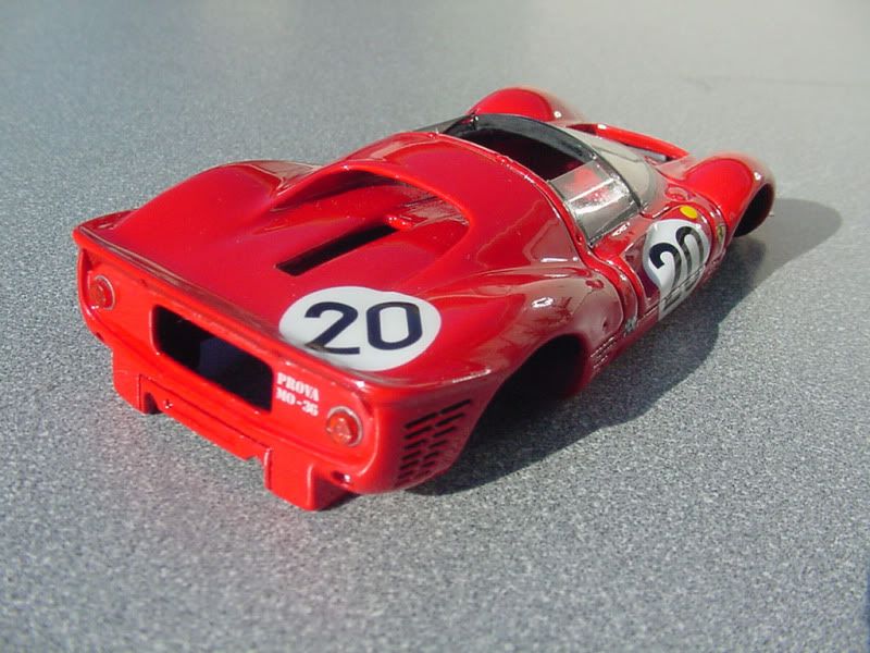

The clear is on and some detail painting has been done…

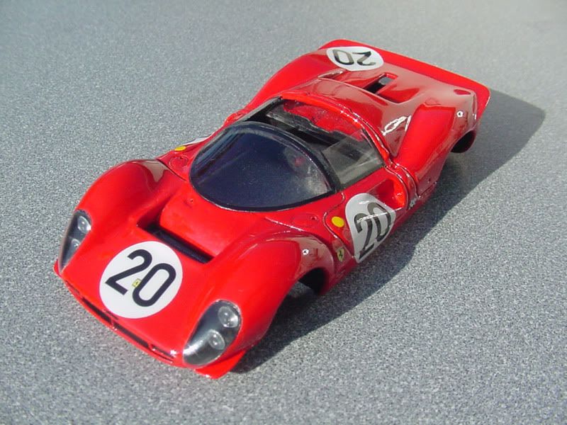

The kit did not come with windows, not that it mattered too much, the kit was supposed to only supply sheet clear plastic. I made a template for the windshield and rear window, the side door windows were made from measurements. Like the real car (unfortunately) they mount from the outside. I made decals to clean up the edges were they mounted to the body.
They did provide vac-u-formed headlight covers…
Still more details to add, but I think it is near the final stretch of assembly.

Damn beautiful! Top notch works on the windshield! Did you vacuum formed them from the template?

I guess I should have been clearer in my description, the windows are all formed from flat sheet clear. I made a template from paper card stock for the windshield and once it fit I transferred the shape to the clear material.
The cement holds them in the curved shapes. I did not make a mold or vac-u-form them.
