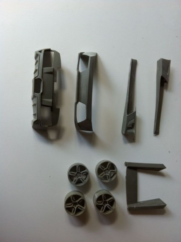

The Car
The Transkit
Amazing detail, the photoetched parts are amazing.
The resin in clean & smooth, almost no bubbles.
The incredible wheels

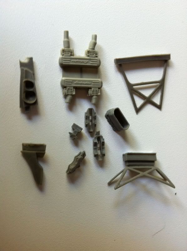

Most of the other bits

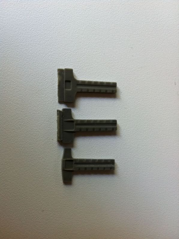

Hobby design supplies you with 3x carbon fibre engine cover things
The photos Ive found show different ones in different cars so I picked the one I liked the most, the bottom one

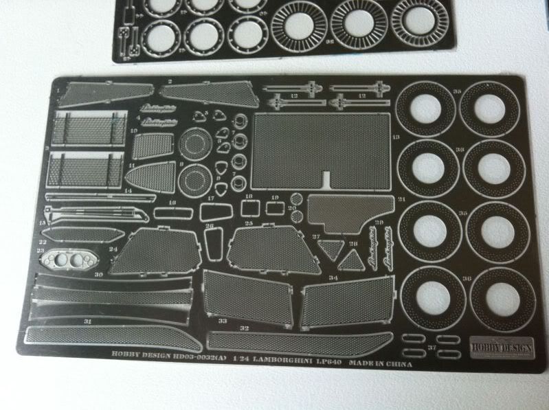

The Photo etch
These are the pieces for the brakes, nuts & the bolts that hold the hat together, pretty amazing detail, should built up nicely

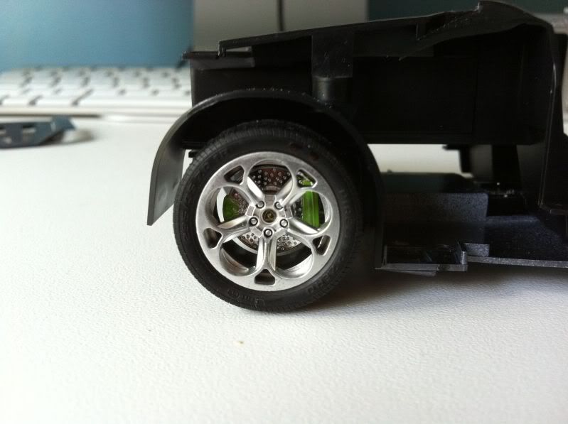

The body as I got it, the previous owner had primed it without removing the mold lines. It was going to be candy green
I do love these wheels, as a bonus the roadster kit came with the original Murc wheels in shinney chrome too!!

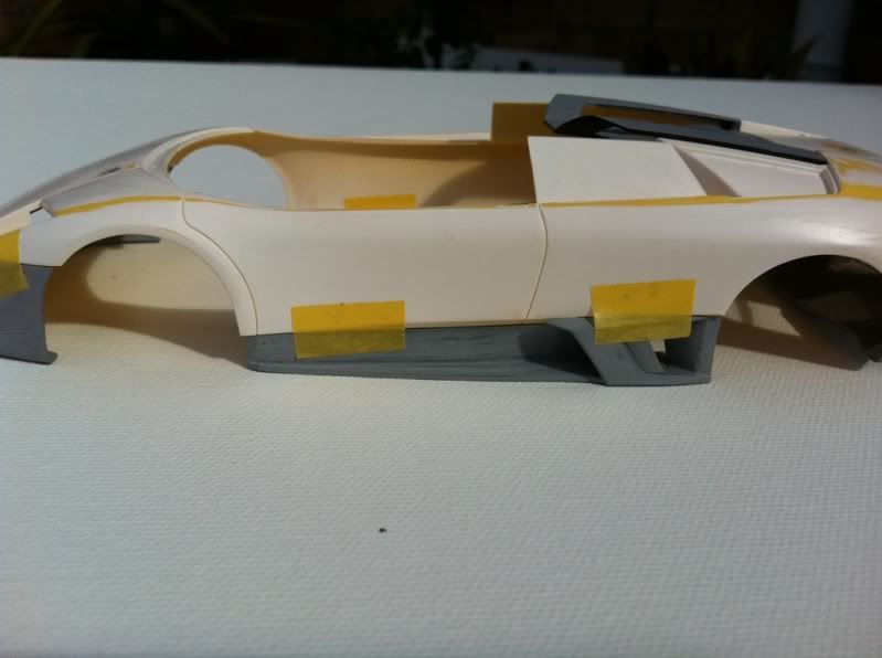

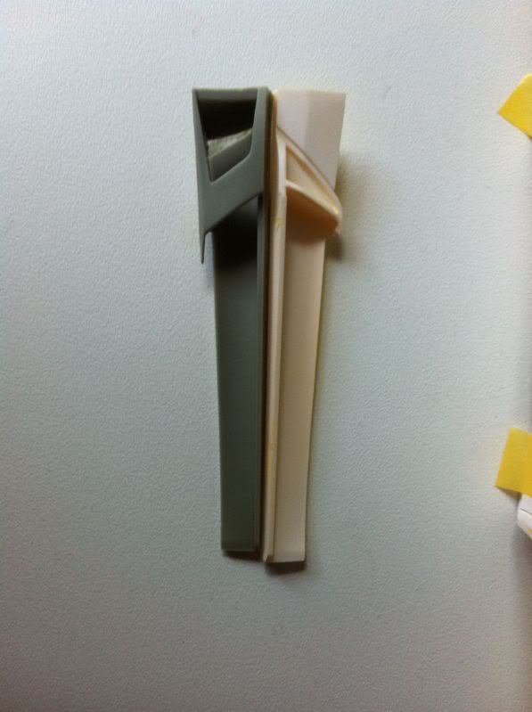

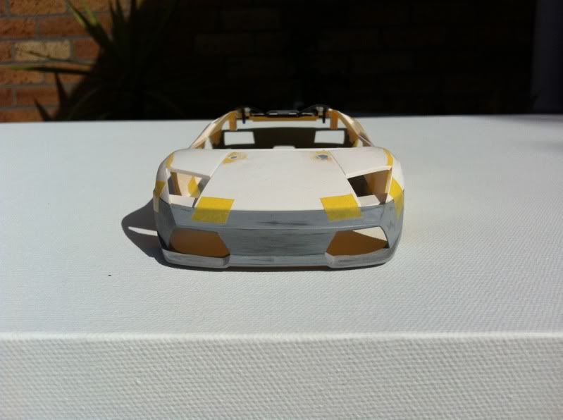

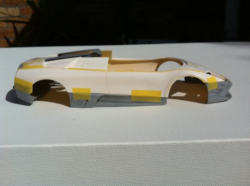

Well, Finally made a bit of progress.
Started mounting up the new resin body panels, most still need a touch of work, some pieces like the fron bumber & side skirts require a small amount of lengthing to math the plastic body. There is also quite alot of other parts that need to be modified so that the new body can be mounted. the Rear wheel housing needs to be reshaped to fit into the new rear bumber, the chassis needs plastic removing to fit the side skirts & same with the front bumper.
Anyway onto the pics!!
Next I need to make the engine cover & make sure all the pe fits
