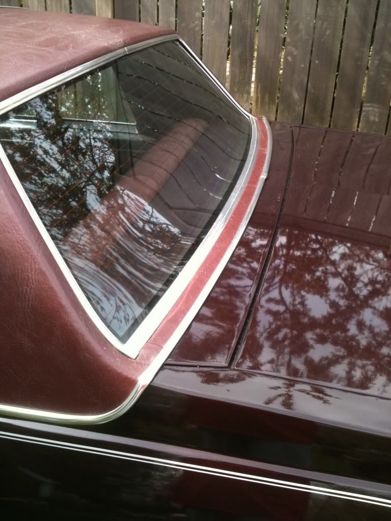

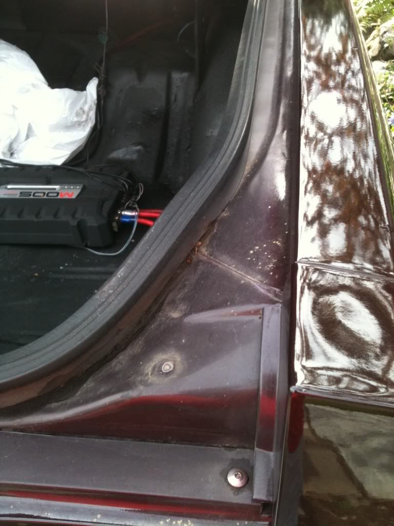

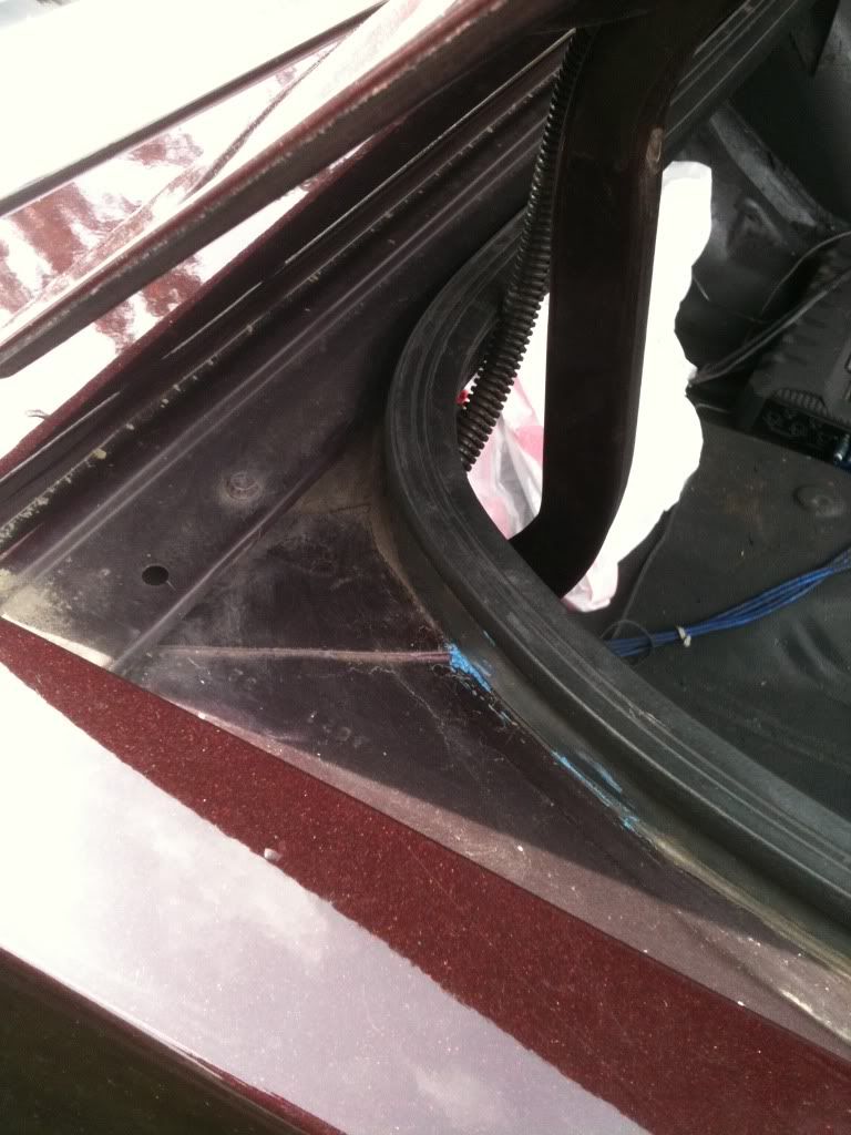

these pictures relate to my leaking trunk...ive ask this question before but need some more help...anybody had this problem...how did u fix it...Its hard for me to find the leak....but its a big one because the trunk floods not just dribbles

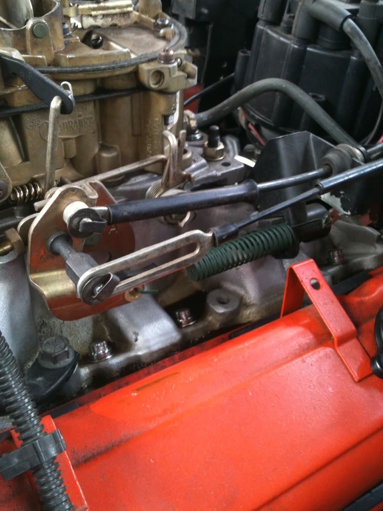

Wondering what that line coming off the front of the carb that isnt covered or plugged is...and what i should do about it...

the carb picture shows cracked vacuum lines replace all cracked and hardened vac lines ..make sure you get all the correct sizes..
this I see has what looks like a T fitting with a rubber cap cracked avoid using the rubber caps to block off the plastic fittings as they fail quickly..
the plastic valve assembly that you asked what is this for is you cannister purge valve..this fails quite often. when it does it sucks fuel out of the fuel tank and will flood the carb...make sure it is not wet with gasoline...[internal diaphram ruptures causes this.........]

forgot to mention.....the carb tubing , that needs a vacuum line is for the OEM air cleaner...this would go to the air temperature intake controller..this keeps the air going to the carb at about 105 deg f...when this is dissconnected you have a very large vacuum leak and the choke pulloff will not work......
this heated air allows the engine to run smoothly when it is below 50deg f air temp...I am quite sure this engine must use lots of fuel and has a bad hesitation....I would also expect this engine to start and quickly stall unless you floor it to keep it running..

Regarding your leak, get a trim removal tool and remove the trim around the back window and look for rust holes in the window channel area at the bottom of the back glass and under vinyl top. A very typical rust prone area for these cars. If it's leaking as bad as you say, just open the trunk, run some water down the back window and see if you can see where it is coming from. And yes, you will have to remove the door panel to replace your door handle, no cables, very easy to replace.

Just plug the open vacuum port at the top of the carb, as said, it would go to your stock air cleaner that you are not using. There is a procedure in the factory service manual that tells you how to check the canister purge valve, don't recall it off hand. If yours is old, chances are it's bad.
