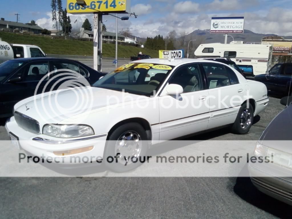

Looking at a 99 PA for sale, this thing is nice! It has seprate climate control, vents in back, leather. Nice!
It's a one owner car, with 99,000 miles on it. It's on consignment, asking $4,800. I would offer $4,000.

Here is a picture of the Park Ave.

Check the RPO codes for the F41 "Gran Touring" Firm Suspension package. The chrome wheels are not the standard ones included with the GT, but were an option as well so may still have GT. If you have FE1 (soft suspension) then no GT (GT adds stiffer springs, thicker sway bars, and NV8 magnasteer). NV8 was standard on the Ultras (97-05); F41 is standard on Ultras (03-05).
