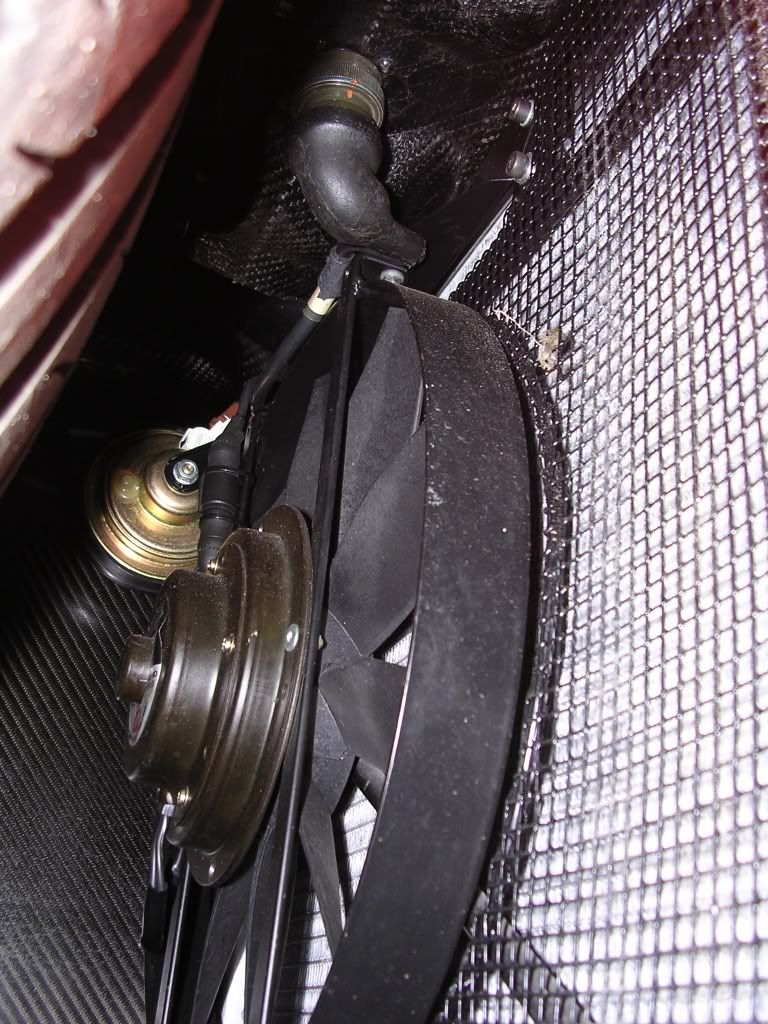

Whenever I've seen #12R at Goodwood over the years, I've taken some detail shots, and one of them was this -
Any good to you?

Sure is, thanks!
Could you tell us the location and orientation of this shot?
By the way, is there any opening on the floor? (I do not see any on my model car )

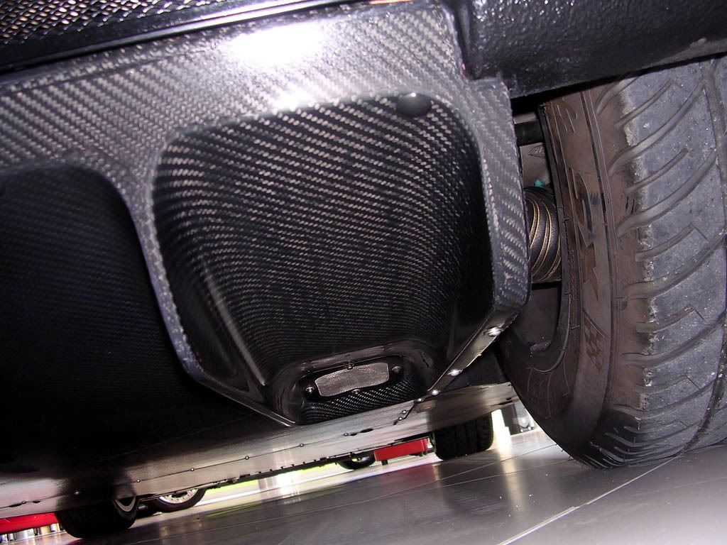

From Le Man's picture it seems the fans are located inside the monocoque. The air comes in through the wheelarch opening and exits at the bottom floor level.
Hurstg01's photo displays what I believe is a duct for the alternator cooling, and confirms the lack of space in this area. It comforts me with the idea that the fans are situated in the flanks.
While the output of the "fan" used on the Chaparral 2J was +55 hp, I would be curious to know the total output of the fans used on the F1. Obvisouly it will be nowhere near 55 hp, but it would be interesting to know.
The text I've highlighted in red is incorrect.
If Greg doesn't mind, here's one of his own photos of #013 showing where the air intake is located on the underside of the car at the leading edge of the rear diffuser. There is an identical vent in the channel on the other side as well.
>8^)
