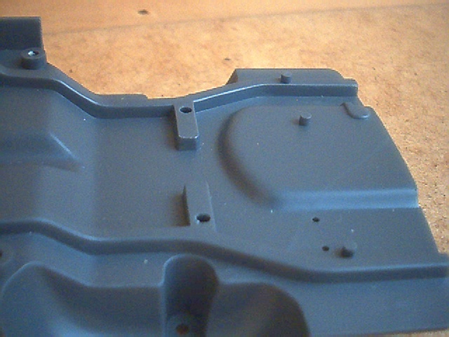

I have begun a second GTR but it's not finished. I have some pics of the modification chassis, I hope that help you:
The follow pic show you the lowering (maximum), I think your choice for 17" it's good:
For the front I don't know.

For the front my problem is the suspension, with the Fujimi is not a problem you cut the suspension but with the Tamiya I don't know......

Perhaps cut and shorten every parts, that get in the way?
You also need to bend the front axis and and lower A-arm.
