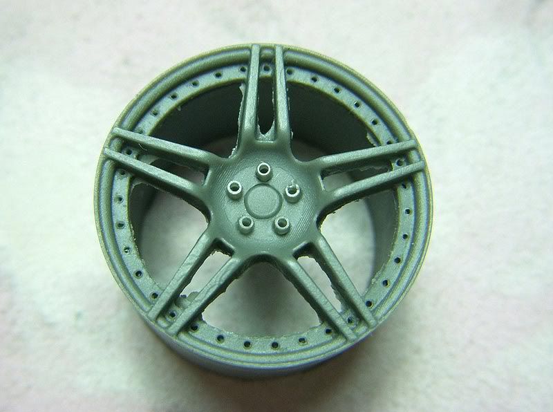

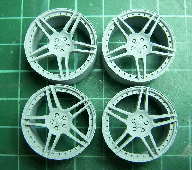

Detail & closer look at the HD's Novitec Rosso wheel
http://www.automotiveforums.com/vbul....php?t=1018012
Many imperfection on the wheel, sanded, filled, sanded, filled ...boring process...
Here's the result, still require some touch up

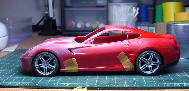

Novitec Rosso's rear wheel was 21", mine was 20", so it looks a bit small at the rear

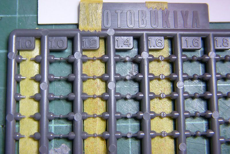

On the rear bumper, there should be 4 round reverse sensor
so i drill holes using 1.2mm drill bit and insert some kotobukiya's parts 1mm rivet

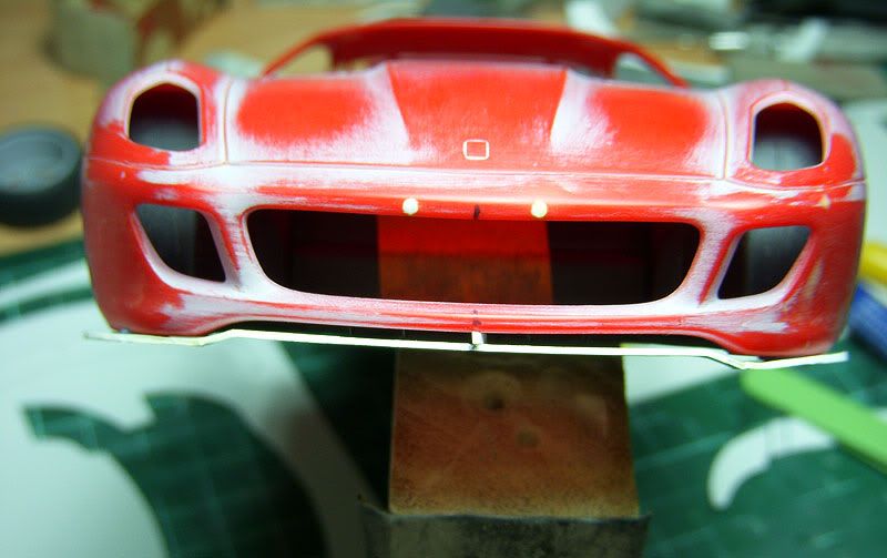

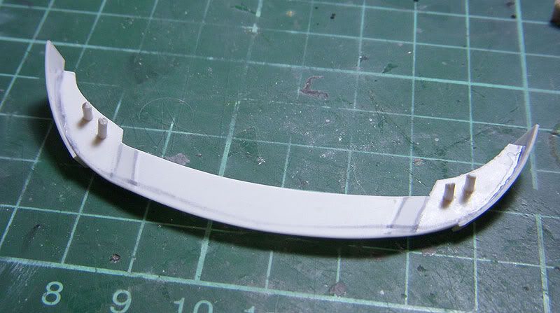

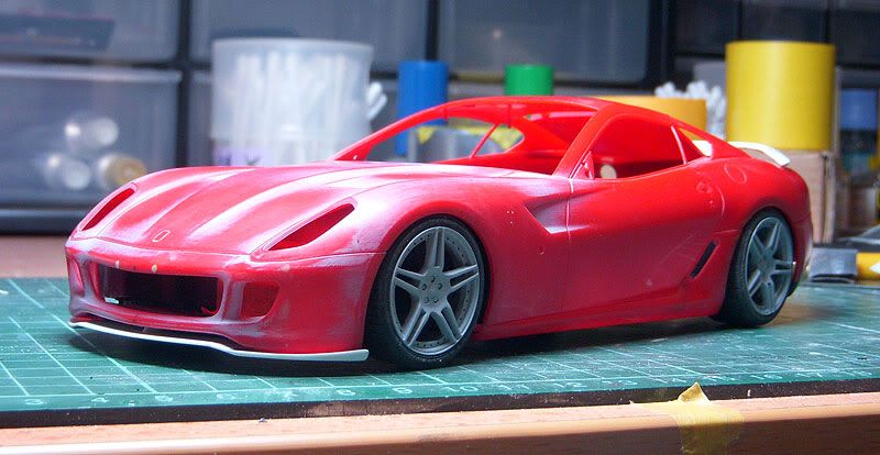

The Front Splitter

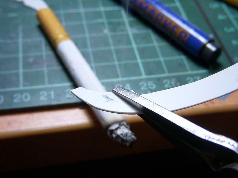

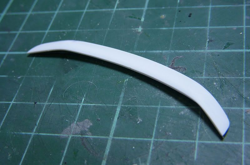

First i trace the 599 front bumper's shape using masking tape, then i transfer it to a piece of plastic card and design the shape of the splitter.
After that i trace the shape again using another piece of masking tape and make few template on 0.5mm plastic card.
I draw line where the bend will be and by holding it using a plyer, i heat it up using cigarette's smoke's, after few seconds i bend it. I try lighter before but the flame is to much and warp the thin plastic (by bending it without heat will weaken the plastic, and please non-smoker don't buy a pack of cigarette because of this )
here's a rough shape (actually this is the 5th attempt)
after i confirm the position, i drill holes from bottom and insert some plastic rod
After some sanding, i glue some 0.5mm bended plastic card at the side
TOP VIEW:
BOTTOM VIEW:

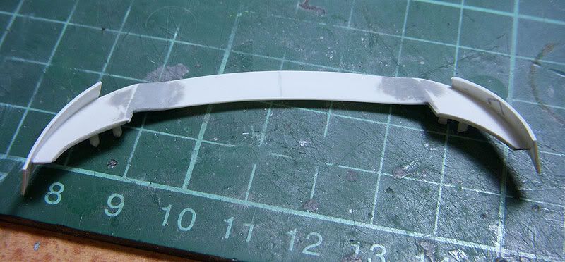

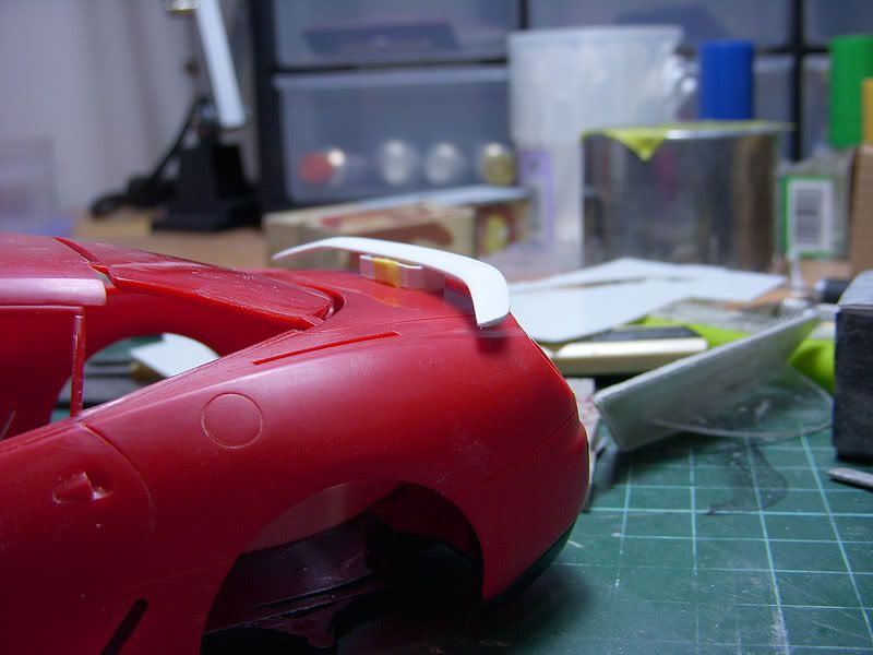

Also my first attempt on the rear spoiler
not exactly what i want, but i'll leave it for now

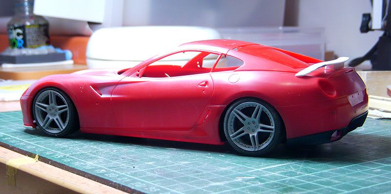

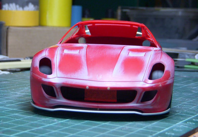

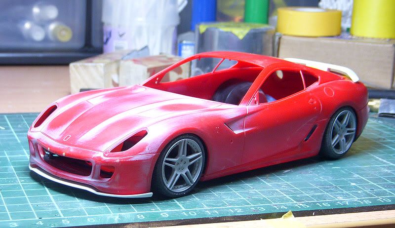

Here's the overal look with the front splitter & 'rough' rear spoiler
Close up on the sanded & shaped front splitter

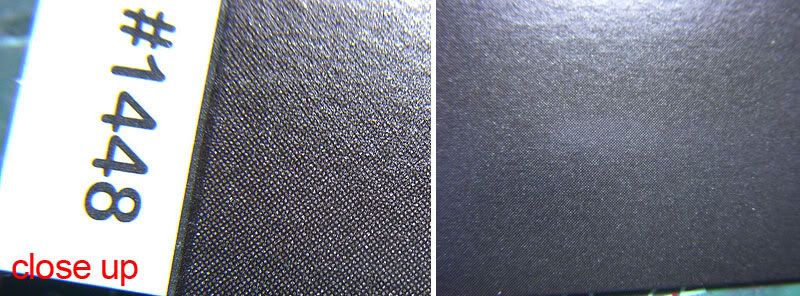

i havent decided whether to use carbon fiber like below which is a 1/48 scale very small pattern, almost black if not look up very close

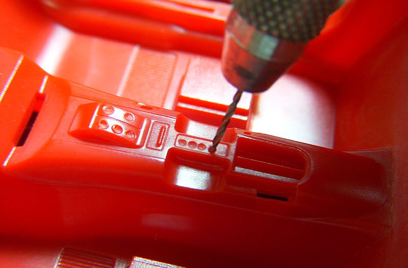

cut out the aircond vent, it will be replace with pe later, also re-scribe the shallow panel line

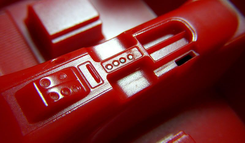

remove the buttons with 0.8mm drill bits
use some 0.7mm round hex from top studio, i use the bottom which is flat to replicate the buttons
not perfect but at least it look more like a button instead of a nipple

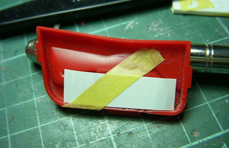

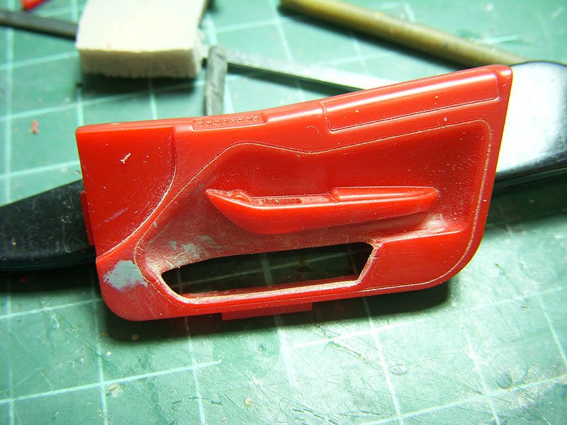

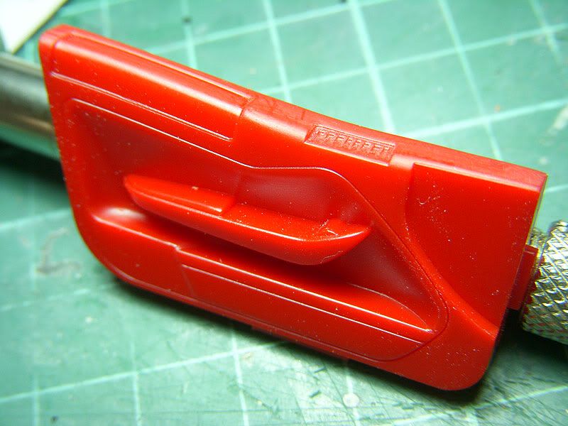

original door
cut out area where it suppose to be holes, initially i just cut where the holes should be, but the confined space make it extremely hard to sand, no choice but to remove everything
then just add some 0.3mm pla-plate

I like the look of the front splitter with the wheels. And about the CF i would say dont paint it and also i would not use the 1:48 scale carbon. I would use some Scale motorsports 1:24 CF it is the best CF ive ever used and verry easy to aplay! But good luck on this one!

Tompidom, the 1/48 CF is from scalemotorsport, i'm worried the 1/24 CF pattern might appear huge on the tiny dashboard but i'll test first & see which is better, also i see that you are also doing a 599, maybe you can try on it first & show us how it looks

The Front Splitter resulted awesome, you got a great look on the car with those wheels, but I have a question, what about those bolt-holes in the wheels, does the kit include the bolts?

ramon, this is how the wheels look like when i got it, no bolts, only 4 air valves were provided

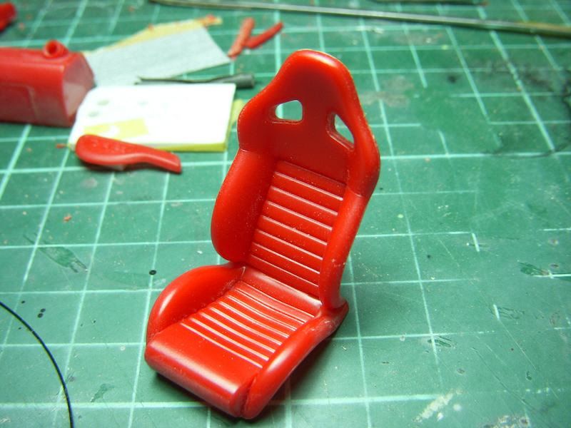

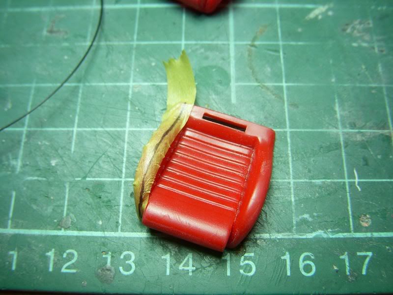

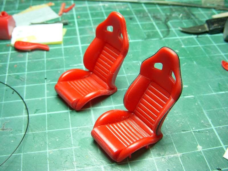

Original seat, nice but lack of detail

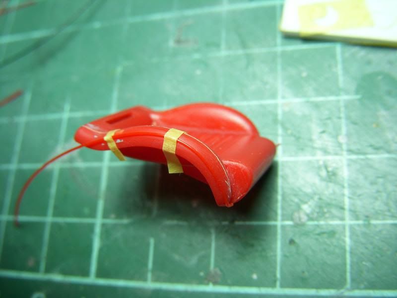

so i add some lining using stretch sprue
position and glue the bottom first, then align with masking tape
apply thin cement along
this is the thin cement i'm using, equivalent to tamiya's thin cement

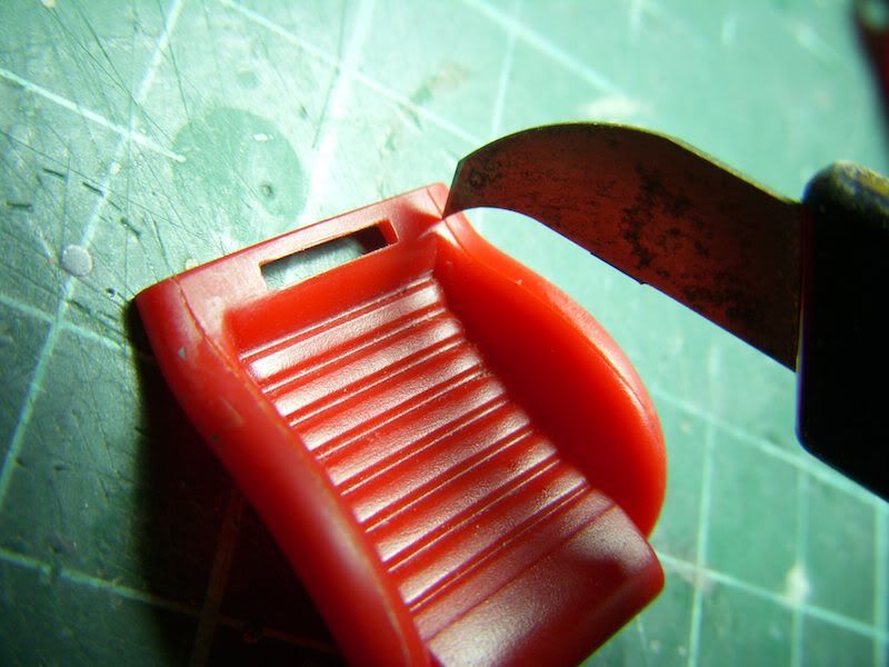

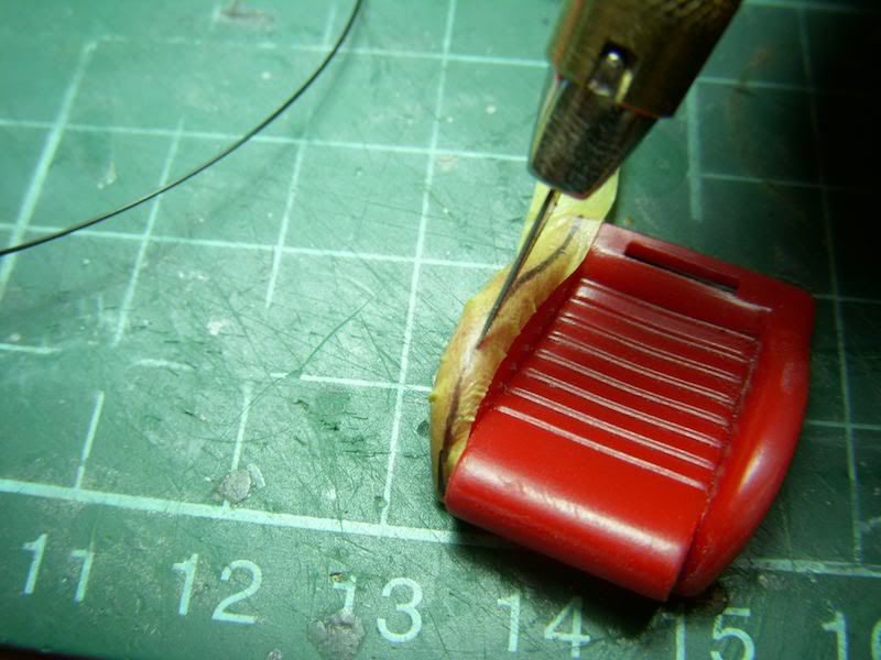

there should be extra stitched panel, so i draw line using masking tape
cut along the line using modeling knife
then i re-scribe the line
this is how it looks

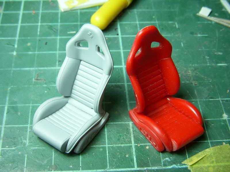

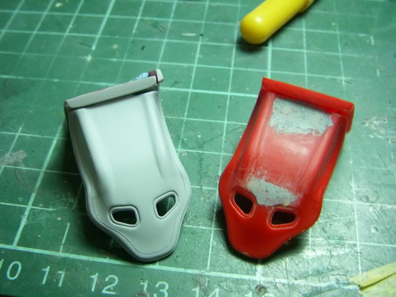

also i scribe the back where the carbon fiber will be
