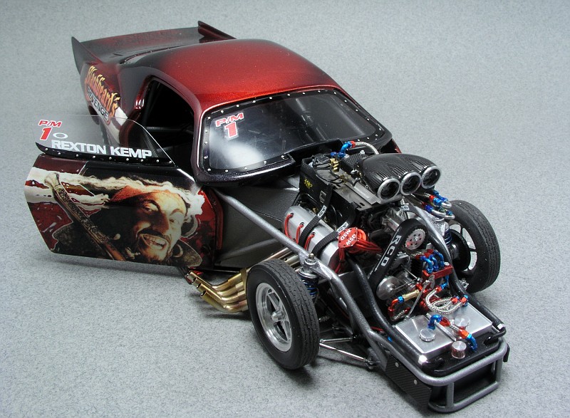

Not a big update, but it was a huge step for me. THE HEADERS ARE DONE! They have been one of the hardest parts of this car so far. I have started and stopped at least five times. But last night I was victorious!
I ended up putting the body and doors on the car, and taping the front end in place, so all of the body was on and solid. Then I flipped it over and tube by tube started adding them and gluing them in place. Once I had four done on the left side I repeated the same process for the right side. I drilled all eight for the sensor lines that will be added later.
Once everything was in place and solid, I took the body off and went out and shot all the Alclad heat staining with hot metal sepia, clear yellow, and hot metal violet. On the car! LOL But it all worked out, and I crossed a biggie of my to-do list.

I worked on the windows last night. I found some .007 clear sheet at Hobby Lobby and used that for all of them. Front and rear windows were made bordered with a Sharpie and then glued in. I used Pro Tech's smallest PE nuts all around held on with Future. I still need to add the inner bracing to the side windows, and some to the front windows. And I'm really not sure about my new driver, but he's pretty fired up about the chance to drive it.
Next up will be finishing the windows and inner doors, and electronics.
