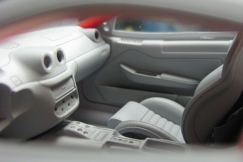

little updates:

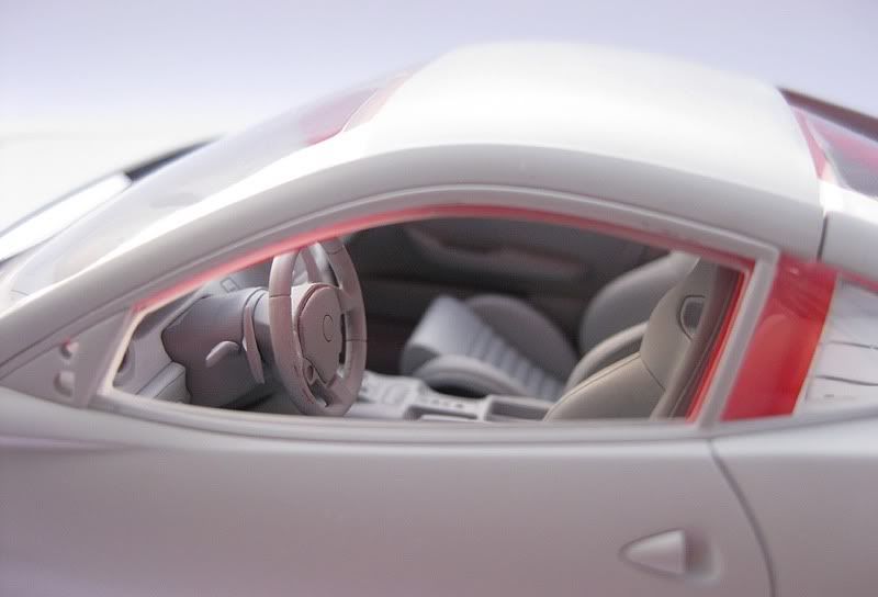

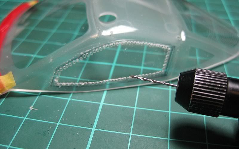

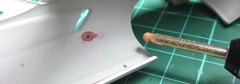

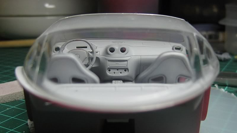

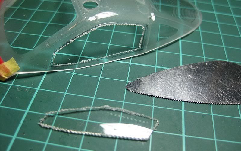

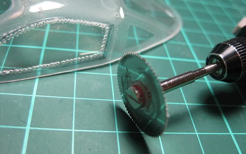

after detailing the interior, it must be wasted if it's not very visible from outside, so i cut the window for a better view, first drill out holes using 0.7mm with a dremel
then some photo-tech rotary saw, carefully saw along the dotted holes
then using photo-etch saw to cut where the rotary saw can't reach
until here it just took me around 15min or less, then i slowly sand till i get the right shape, took me around 1 hour
the result, a better view from outside

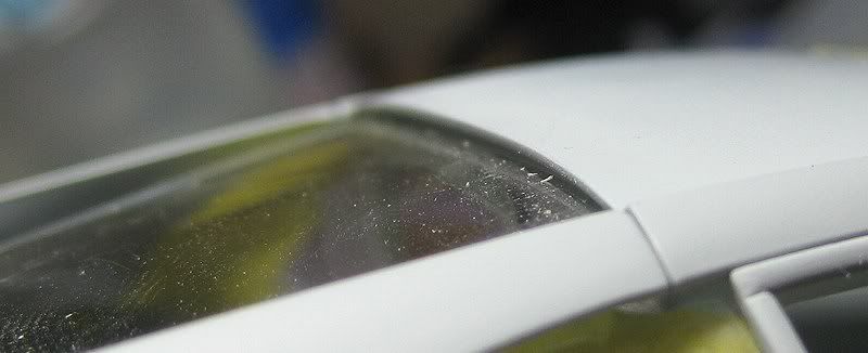

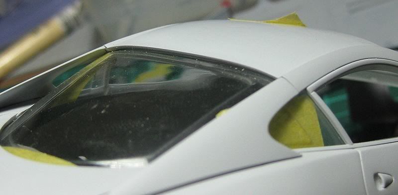

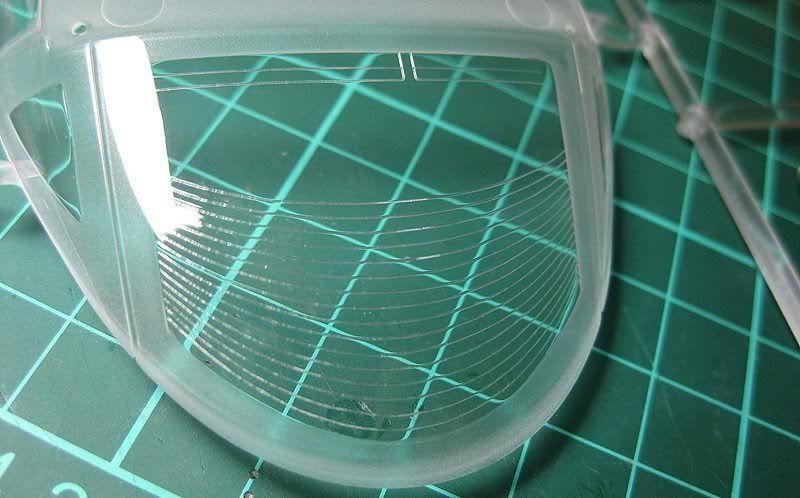

rear window had this defroster thing, but it is too thick and block most of the view
especially this angle
so i sand it off using 600, 800, 1200, 2000 then compound with tamiya coarse, fine & finish, took me few hours
i think i will skip the rear diffuser splitter, tried 3 times with no success, a bit demotivated, since i'm ready to start painting

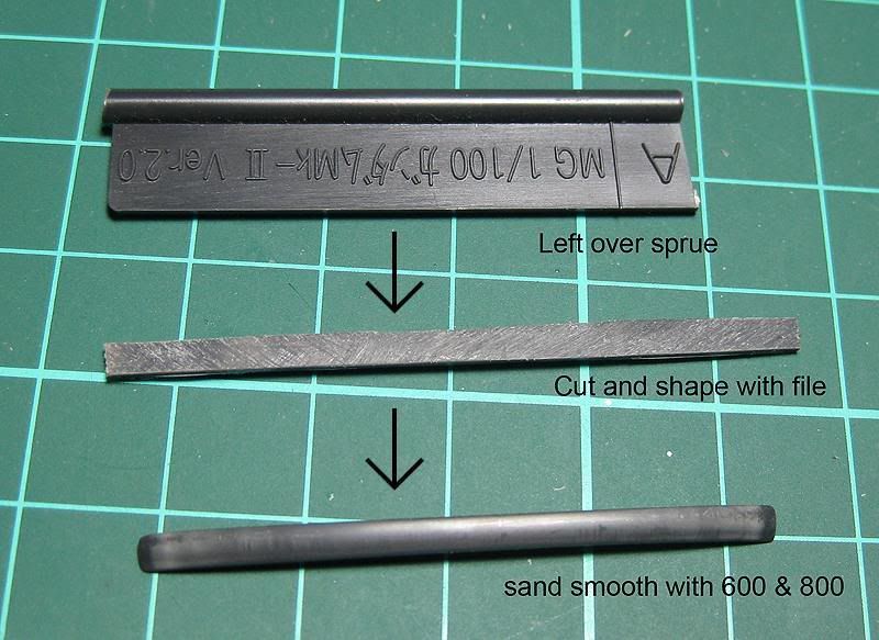

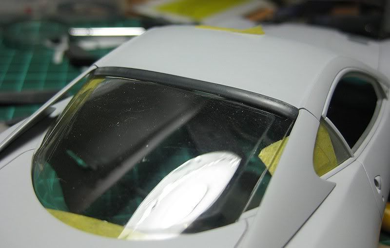

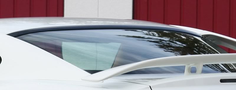

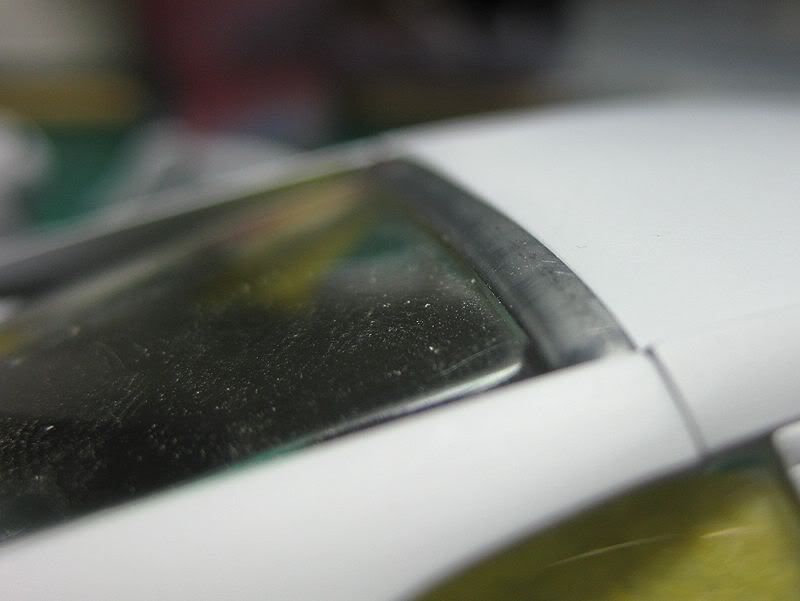

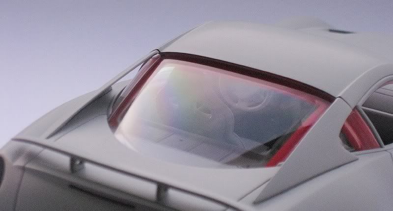

Was test fitting the rear window and realise something weird about it, fit is right but some how there's a gap between the roof and the rear window, then i realise it lack the rubber trim
here's how the real car look like
the kit, a step...need to do something about it
so i cut out some unused sprue, since i dun have the correct styrene sheet, and styrene sheet is white, but the sprue plastic is black, perfect
test fit, looks ok although slightly bigger than the refs

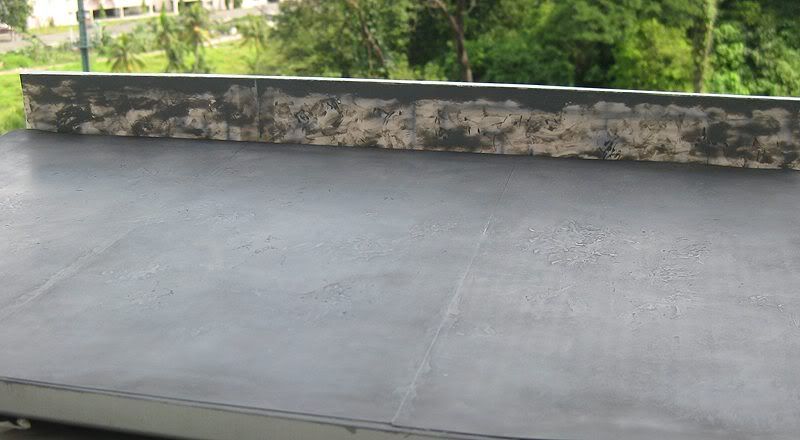

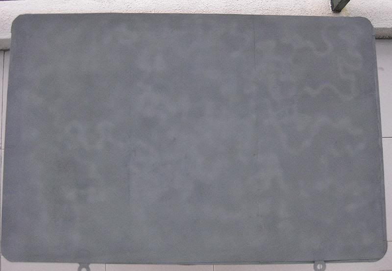

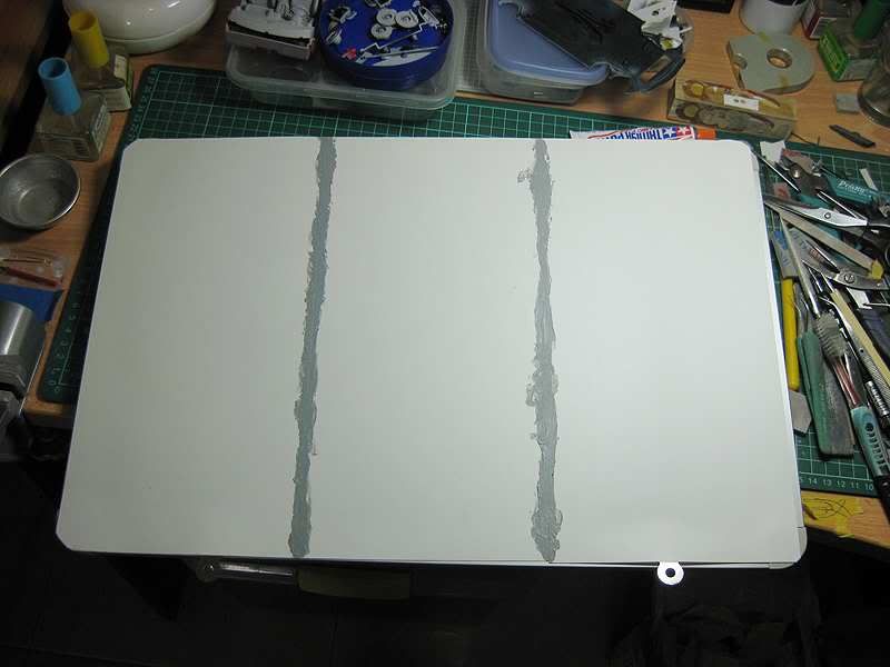

Usually i would use a white background for shooting my cars, but shooting a white car on a white might look boring...so i create a cement floor
i used a cheap note board
glued with 0.3mm styrene sheet, puttied the joint and brush over entire surface with diluted putty for a rough texture
then i spray with tamiya acrylic grey mix with water..the cheapest and roughest way after that randomly overlap some darker grey and also black wash using sponge
looks ok but not very realistic as i do it in a rush

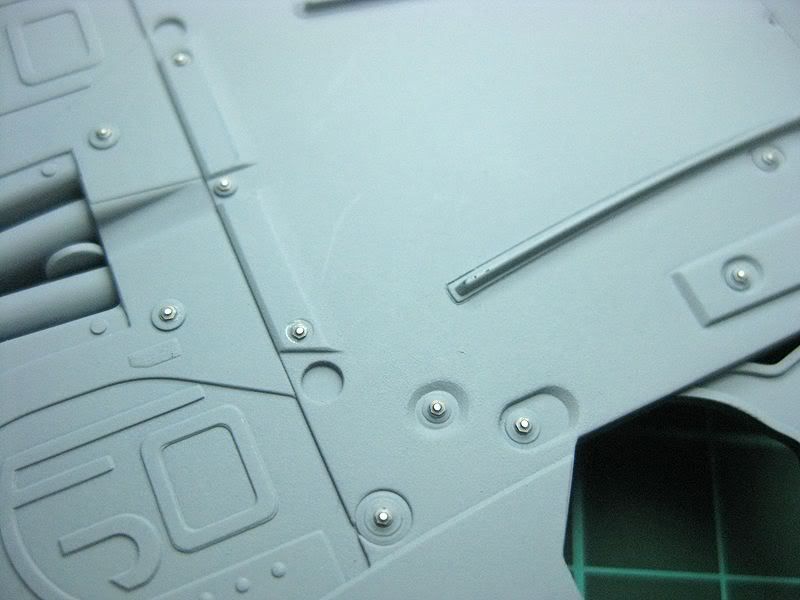

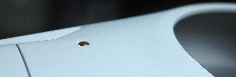

Added some bolts to the chassis, using some PE bolts from LionRoar,
later after painted everything in semigloss black, the bolt head will be scrap off to reveal the bolt head
also i built the wall and redo the cement floor, randomly scratch and dent the surface, then patch with putty and sand over with 400 grit, then spray again with gray acrylics, some black wash and highlight randomly with lighter gray using drybrush.
although i realise the texture's scale a bit too large for 1/24

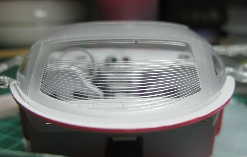

Was test fitting the brake light because i worried after several coat of paint it wouldn't fit, but i broke it when trying to remove it out
1st thought was scratch built from red sprue, but look at the thickness, i don't want to spend several hours of sanding and then break it again
so i tried using epoxy mix with smoke clear, since i want it to be smoke like the novitec's version instead of clear red, but doesn't came out nice

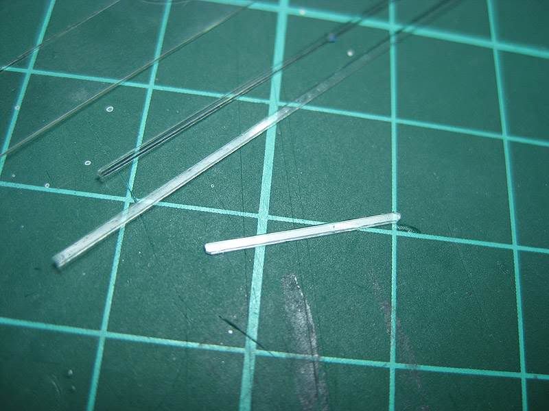

2nd attempt using clear pvc
cut into small strip
because it is thin, i need to insert 3 times to get the right thickness, looks ok, now i just need to paint it without scratching it during final assembly

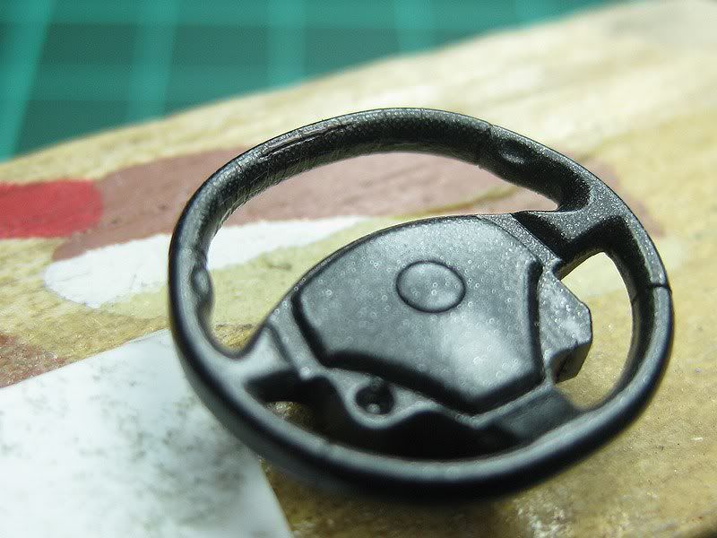

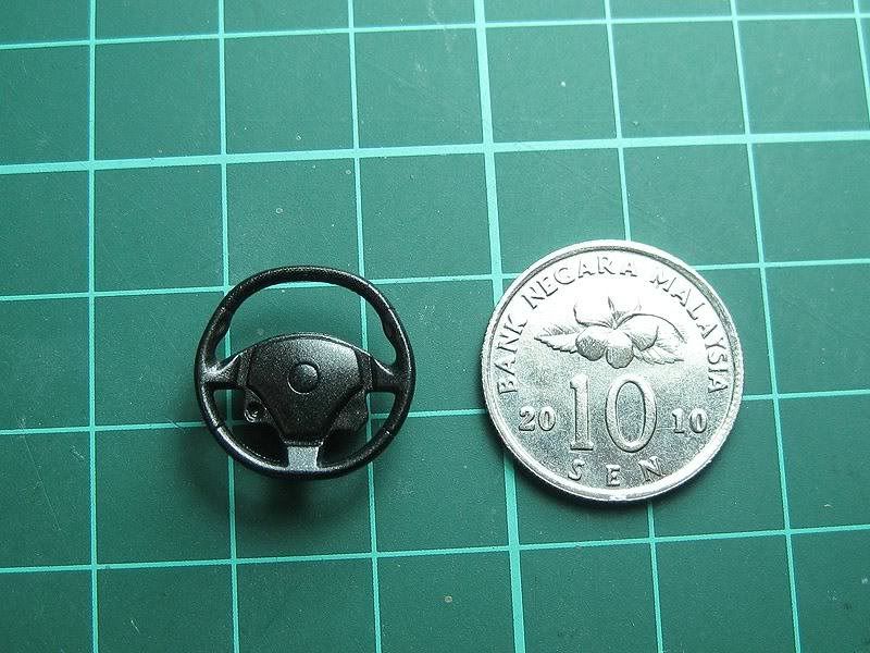

try carbon fiber the steering column, quite tricky because of the small size
size compare to 10 cent, honestly the CF wasn't visible if u don't look really close

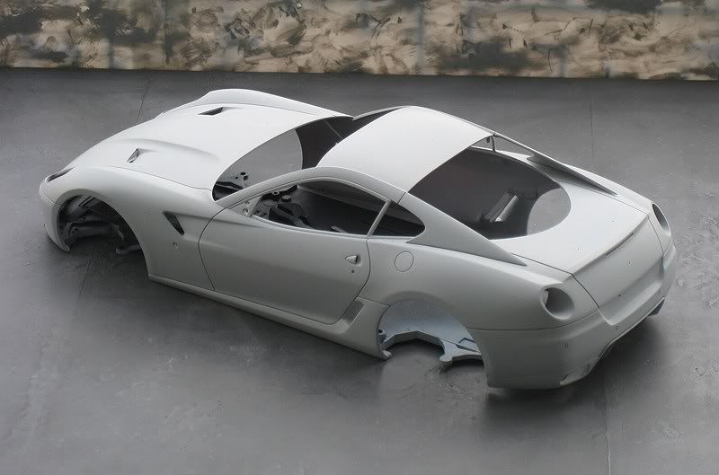

last check the body, it's good to start painting
