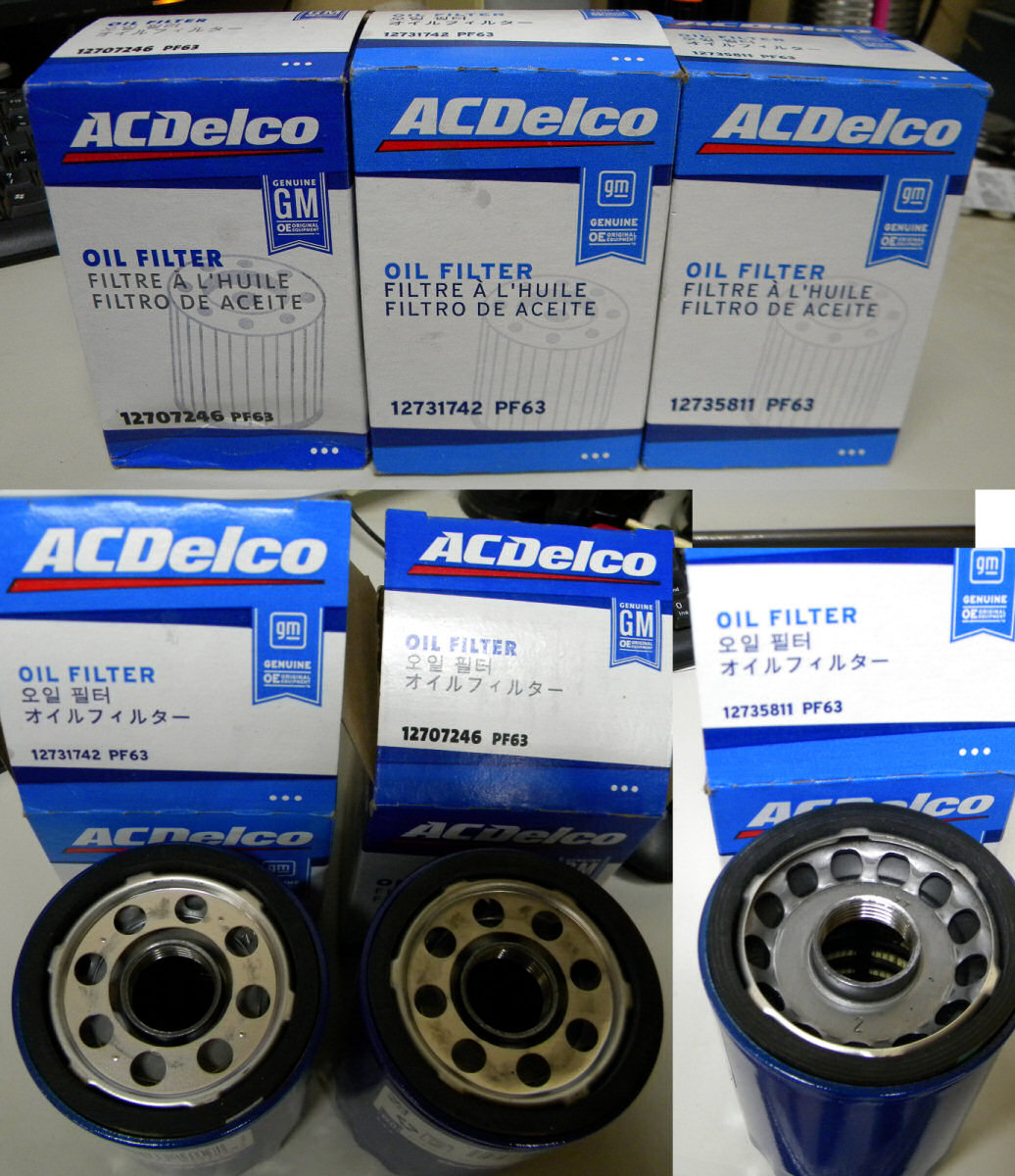

GUESS WHAT? GM / AC Delco has ONCE AGAIN changed the design and Part Number for the PF 63 Oil Filter! Good Grief.
Did an oil change on my girlfriend's 2016 Traverse yesterday.
Bought the oil & filter at Walmart. Same PF63 designation, but now it is Part Number 12735811. If you look back to the top of this thread, the issue was with the same PF63 filter. AC Delco switched to a horribly BAD P/N 12707246. Then they changed it again, to the GOOD P/N 12731742. Now it is 12735811. I have no info on what exactly was changed, although it does have a noticeably deeper recessed area around the threaded base plate. It looks like it would allow for better oil flow, especially in cold temperatures. Man, I sure hope they did NOT lower the bypass pressure like they did on that awful 12707246 P/N. If anyone has any info on the P/N change, please post it on here. I will keep checking the oil in the vehicle. It got dirty really quick with the bad P/N that was not actually filtering the oil. It always stayed really clean with the good versions of the filter. I will report back after it logs some miles. If you have a Traverse that uses a PF63, and you find a store that has ones marked with P/N 12731742, you should buy as many as you can. And please let me know where, so I can order some! Thanks, -Jim.

I noticed that back in September 2025. The '246 and '742 had very similar mounting bases, while the '811 has a lot more holes and the deep recess.
www.wwdsltd.com/files/PF63Compare.jpg
