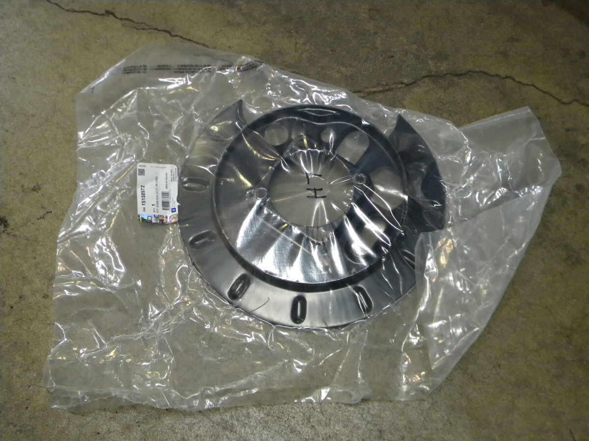

Also--thanks for the tip on the rear dust shields. Ordered 15158972 (left) and 15158973 (right) from Amazon; about forty dollars with tax. Strangely, one was priced lower than the other by about four dollars. Apparently, made in Thailand. Thanks, gm
https://www.amazon.com/ACDelco-15158.../dp/B00496JPP2
https://www.amazon.com/ACDelco-15158.../dp/B00496NG3Y
