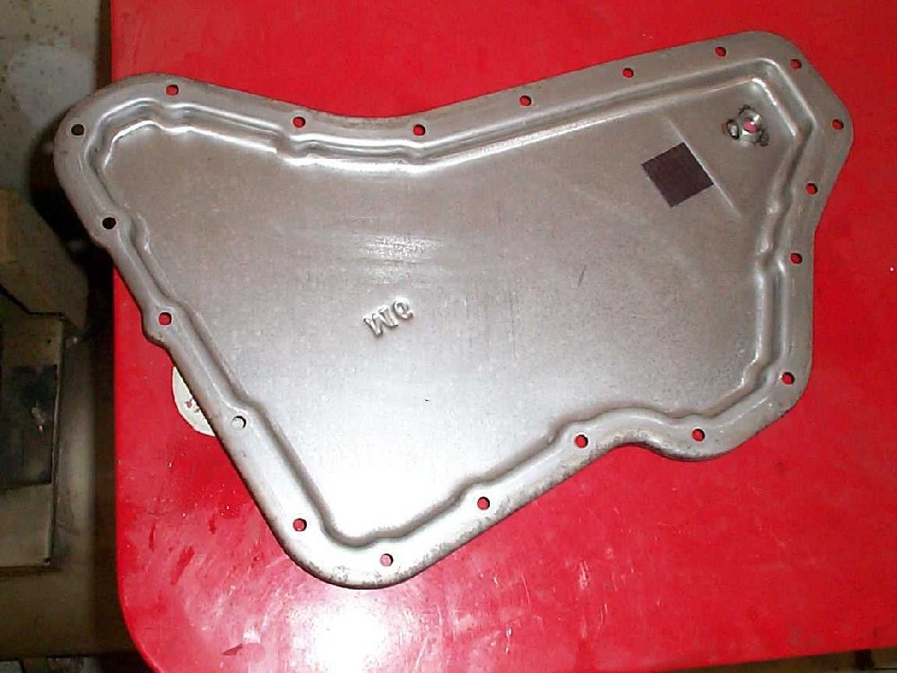

When removing the pan it may be helpful for future service to install a drain plug, like this:
