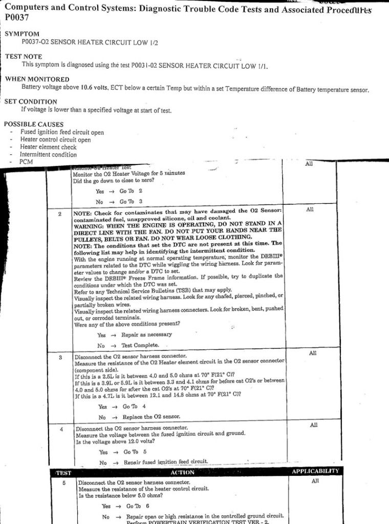

have a code p0037 (heater control circuit low(bank 1 sensor 2)
this truck has 4 sensors could any body tell me which of the sensor is bad thank u 4 the help or how to go about findind to check them

There is some info that can help you.

thanks for the info i went n bought a new sensor and i even put a use computer and it still keep code keeps coming up any more ideas thanks
