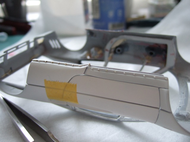

I choose Revell's mirror. Fujimi's are too small. But still Revell's mirror stay were too skinny.
So I applied 0.5mm plastic papers on the stay, as you can see.
Using files and sand papers, the mirrors were made to be preferable shapes.
