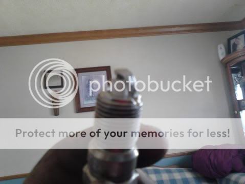

Thats how the old one looked like when i pulled it out, this is the new one that i put in, and replaced. I just happened to have pulled the first three out. 2 out of 3 were fine, this one is not, the gap is closed and the prong is touching the spark plug, and the first 2 or 3 threads look damaged. The car hasnt even ran or started since i put the new ones in. Oh and this is the same location as the old spark plug that got destroyed. The middle section on the front.
"Troubles will come, they will pass."-Lynyrd Skynyrd
with it bent closed like that i hope you never put a hole in the piston? i would run a thread chaser therw the cyl's before you have to put a helicoil in it.

Re: Timing Chain, or Spark plug or bad gas reason for no start?
My brothers cousin messed up the rear spark plug threads in the middle whenever my brother had it, some how he fixed the threads? Im wondering if this kinda has something to do with this spark plug being jacked like this. Although this plug in the picture was pulled from the front middle, not rear middle where the threads got jacked.
