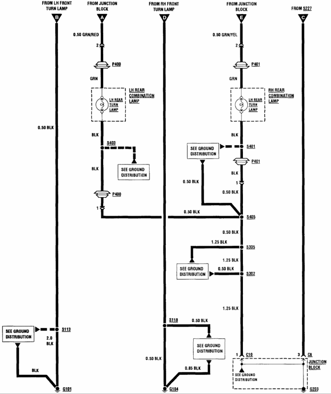

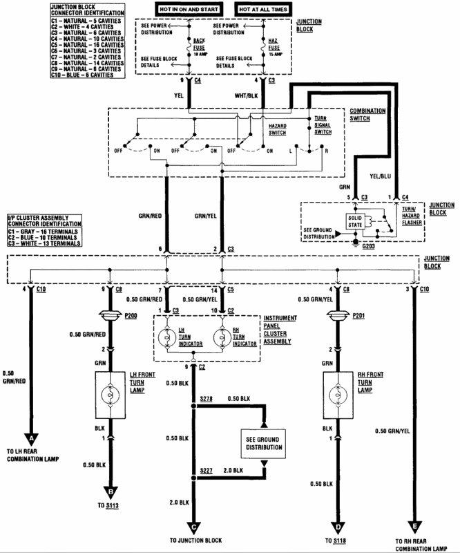

I finally got time to try MMM's fix and it worked! I have some photos that I will post later.The mystery problem I was having with the ignition fuse blowing is gone and when I tried it started up great. The only problem is now the rear turn signals are not functioning. Neither are the rear hazards. I know they worked before and that the problem is back near the junction block.
Does anyone know of something that could make the rear turn signals not work? I took all the harnesses out of the block and hooked it all up again looking for bad connections but could see nothing.
Jai
Turn the key to the ON position, click the turn sig arm to L, then R then check and see if your FRONT Turn sig bulbs light up and flash like their suppose too? Engage the hazard switch and check again? It's doubtful with both bulbs BUT, did you try a new bulbs in the rear Jai? Get a 12V Test light, do the the turn sig arm test again, then start at one of the Rear turn sig bulb sockets and check for voltage at the GREEN Wire, repeat at the other socket....If your getting 12V's at the wires, then bulbs are gone and need to be replaced. ALSO, The grounds for these lights and harness need to be checked to ensure their clean and making good contact? If no voltage (And front lights are flashing)....The green wire(s) need to be traced back to the front for a open or shorted wire with the 12V Test light. If the fronts DONT flash either.....I'd suspect a bad flasher unit is the culprit. (The turn signal and hazard flasher is located under the left hand side of the instrument panel near the fuse panel) You can usually locate the flasher unit, engage the flashers and touch or hear the flasher unit and tell if it's "Clicking" inside? Here's the wiring diagrams for the Turn signals and Hazards.
Turn Signals and Hazards wiring #1
Turn Signals and Hazards wiring #2
