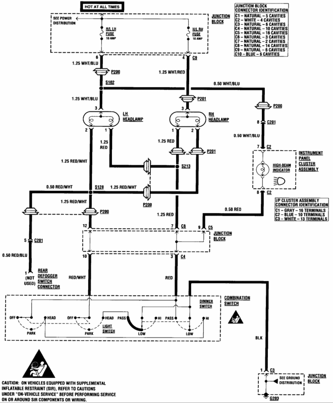

Here's the question. What circuit does that pin belong to? I had always thought that was for the lights, but the wring diagram says that white wire with black line is for the ignition. Each headlight should have it's own circuit I believe.
Jai

Just a quick reply without looking at the wiring diagram. What you are showing is what I remember and that wire is supplying power to the switch for the headlights. The wire is just large enough but the connector is just too small. The copper bar supplying the power to that connector is on the outer edge of the fuse box and can be accessed by seperating the fuse block halves and then cutting a hole for the new wire to go through. It sounds as though you are definately capable of making the modification but just as an offer to you or anyone else; since you got two spares, I would be willing to modify and return one to you in exchange for your second spare.

Headlamp Circut

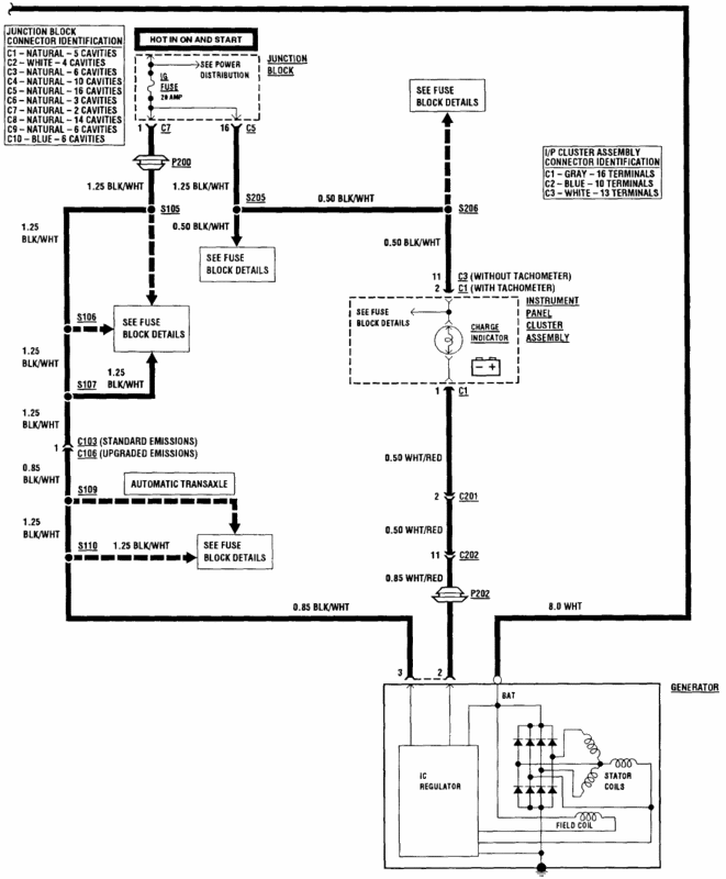

Ignition switch and Starting and charging (Part 1)
Ignition switch and Starting and charging (Part 2
