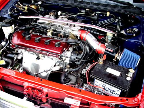

Hi, Ive had my sentra for 5 years now, along with many mods. but most recently (year ago) i had an engine replacement that being a Crate engine same stock GA16DE. Well, everything has been fine and dandy up till bout a month ago. When I noticed that my oil and Water were just disappearing bout once a week, along with White smoke and loss in acceleration during the white exhaust bogging issue. the bogging happens pretty much only when I turn left...and it idles kinda rough not like its gonna die just kinda vibratey. There have been no overheating issues at all from what I can tell, I just gave it new NGK Iridium LX Spark plugs, gave it a full oil change, cleaned the water resevoir and filled it, Brand new Alternator, brand new Starter. It was fine for the first 2 days but after that the issues started up again. i dont see any leaks. the new engine only has bout 35k on it, a head gasket issue seems a lil far fetched for such low mileage. i only drive it to and from work most of the time.
I called my mechanic and he says it sounds like a head gasket problem, I grabbed my neck, squeezed and shook repeatedly!
Any other opinions or ideas for the issue?
I dont think the only 2 engine mods i have could conflict with the issue i have, il just show you a couple of pics...

sounds like a HG to me. it really doesnt matter if you have no mods if you cant drive. for instance, one kid i knoew who was an idiot put a rod thru his stock ford probe's oil pan. well it was a stock JDM mazda engine but same effect.
