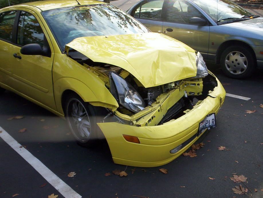

heres another to attest to having ABS in the car as a good thing......my car was totaled 2 months ago because i decided to delete the ABS when i upgraded my brakes and threw on my new suspension. it was raining and a car cut between traffic and ended up in front of me, i slammed into the guy going 50 miles an hour while his car was at a dead stop. my brakes locked and i just slid into him.
EDIT: sorry! i didnt know the pics were so big on my host.
