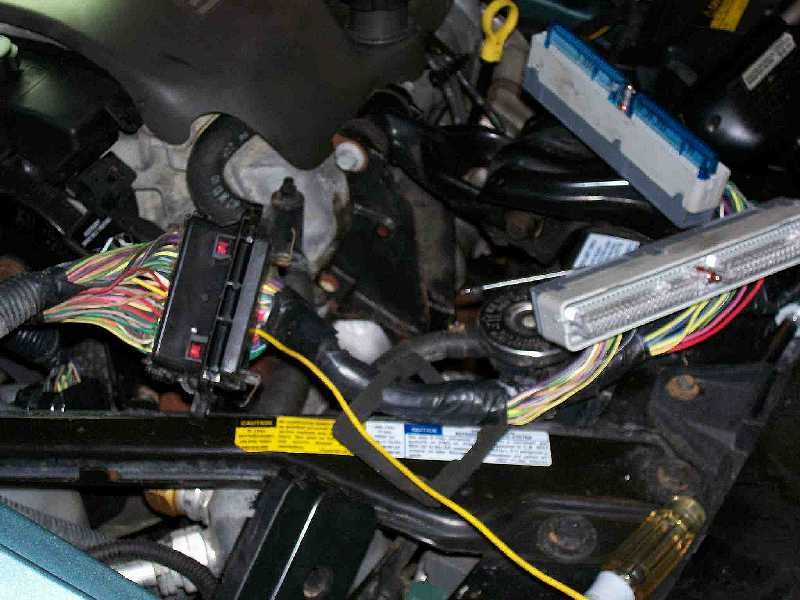

I know the '96-UP U-Body FWD vans had the PCM under the hood, and have had problems with those PCM connectors in the past:
