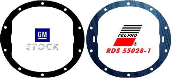

Yes. Either trim out the factory gasket or sealant that was used to seal the cover or install a FelPro cover gasket with the proper openings in the sides to allow oil relief:

Blue Bowtie, I'm just curious as to how this might be causing a leak at the seal? Seems like if the gasket was blocking the oil flow to the bearings it would also be restricting flow to the seal. . Not questioning your knowledge here, just trying to gain a better understanding of the problem. Thanks for your help!
